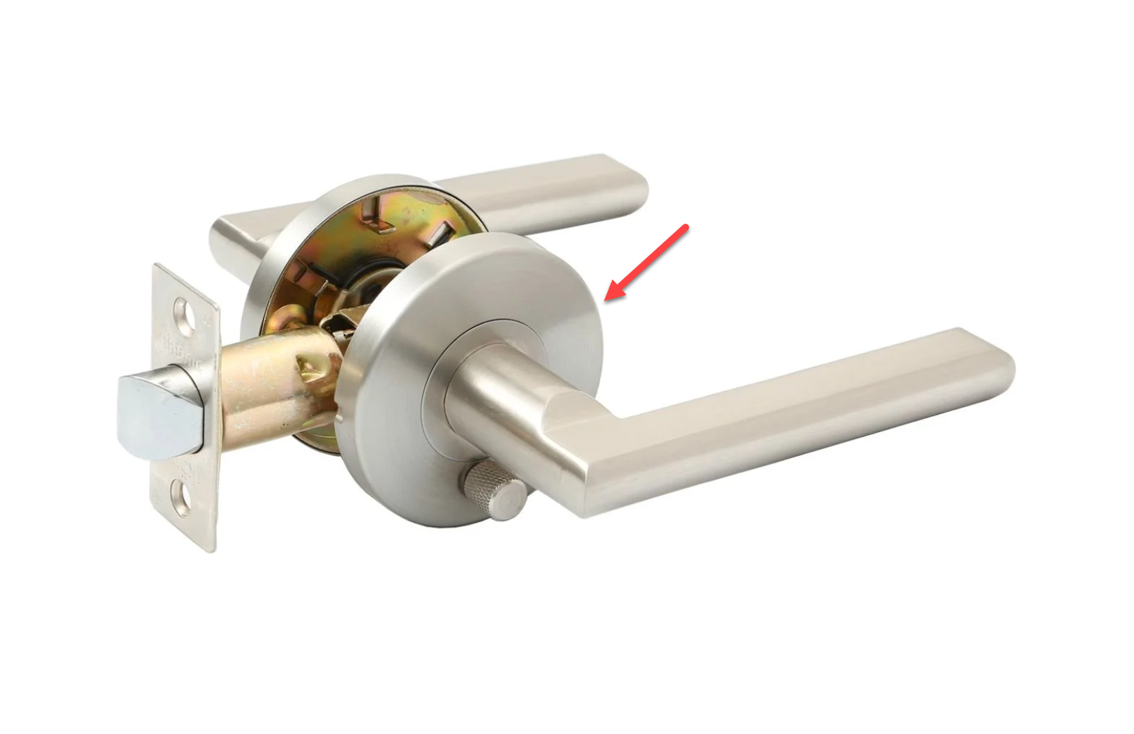

Generally, a door handle is held in place by mounting screws which are concealed by a cover plate at the base of the tap.
They are usually just sitting over a rubber ring, so they can usually be removed by rotating and gently pulling them. Once the cover plate is off, there is usually two screws that go through the door into the other side of the handle. Disconnect these two screws and the handles on each side of the door can be removed, then the latch can be pulled through the face of the door.
If this is not the style of handle you have, or there is a different issue, could you please let me know so I can assist further.
