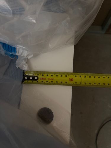

so I am in the clear here if i have interpreted that correct. I have over 100mm clearance so fine to install?
Hi @throatgoat,
Generally, these rules are designed to account for the worst-case scenario, which in this case would be the tap failing or the basin overflowing.
My understanding of the installation manual is that the back edge of the vessel needs to be 75mm from the wall, so that in the event of it overflowing, water can spill down and away from the wall. I may be wrong, but it looks like you've hooked your tape onto the back edge of the basin.
If the back edge is 75mm away from the wall, you would be fine, but if the back edge is pressed against the wall, you would not be.
