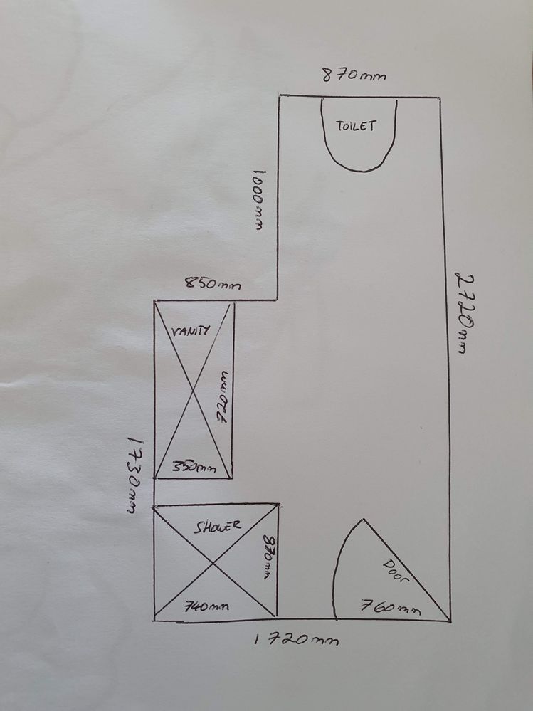

Thanks. Here's something. Hope it's enough. Budget is maybe. 1-2K. Goals are ideally modern, clean, etc. Leaning toward vinyl flooring over tiles for price and ease of install.
Thanks for the sketch @DanTM, I'm sure that will help a lot.
Let me tag some of our keen renovators on the site such as @Mathy, @ProjectPete and @redracer01 to see if they might like to kick off the discussion about what you might be able to achieve with a budget of a couple of thousand dollars.

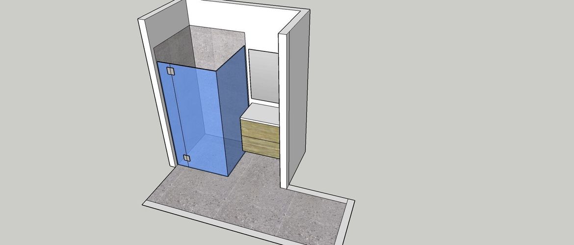

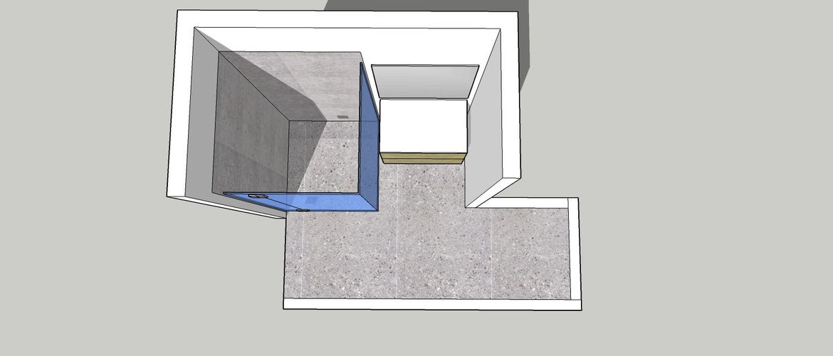

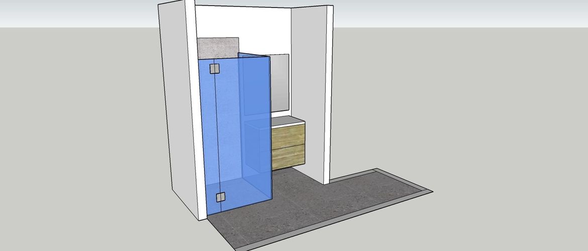

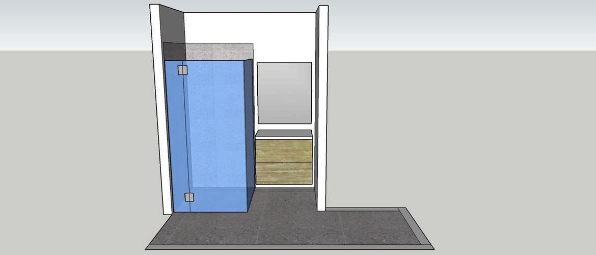

That budget should be ideal for a light upgrade seeing as you will be doing most of the work. I really want you to do it with tiles. So much better and it solves so many problems. If you tile the entire area including the shower area, you will not have to buy a shower tray! You can still buy a shower door and return both framed and frameless the choice is yours. You can build a small plinth ( in cement ) or lower the shower area by just 25mm ( if possible ). Otherwise the shower door and return will be doing all the water blocking. It gives your bathroom a unified level and look, no more ugly shower tray to look at. The vanity you have seems like a ceramic one? yes? If so build your own wall hanging cabinet and recycle the top. But if it is too much effort then standard wall hanging vanity will do ( unless the plumbing won't allow you ). The tile I suggested is both wall and floor applicable. I've placed a frameless so that you will have an idea of what it might look. I hope the drawings have given you an idea or two and have inspired you to explore other possibilities.
Cheers!
Red
Thanks. Looks great. So would this be tiling over the existing ones?
Yes you can! Hower please be aware that tiling over existing tiles carries its own set of challenges. The bottom of the door will have to be cut down to adjust for the increase in floor height. The drains will have to be adjusted. You either tile around the toilet or lift it and adjust. Goodluck and stay safe!
