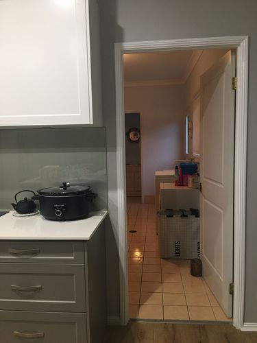

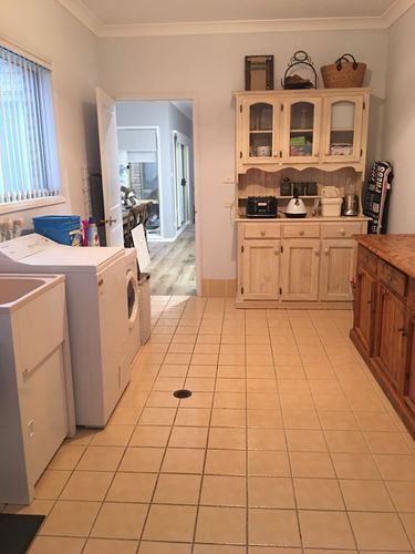

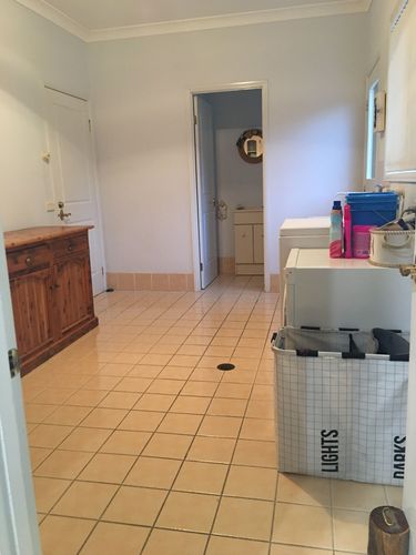

Good morning, just received a quote of $16k to fit out our laundry and pantry and was hoping we could ask for some ideas on how to diy it please? I have attached some pictures. Looking forward to being part of this workshop group 😊

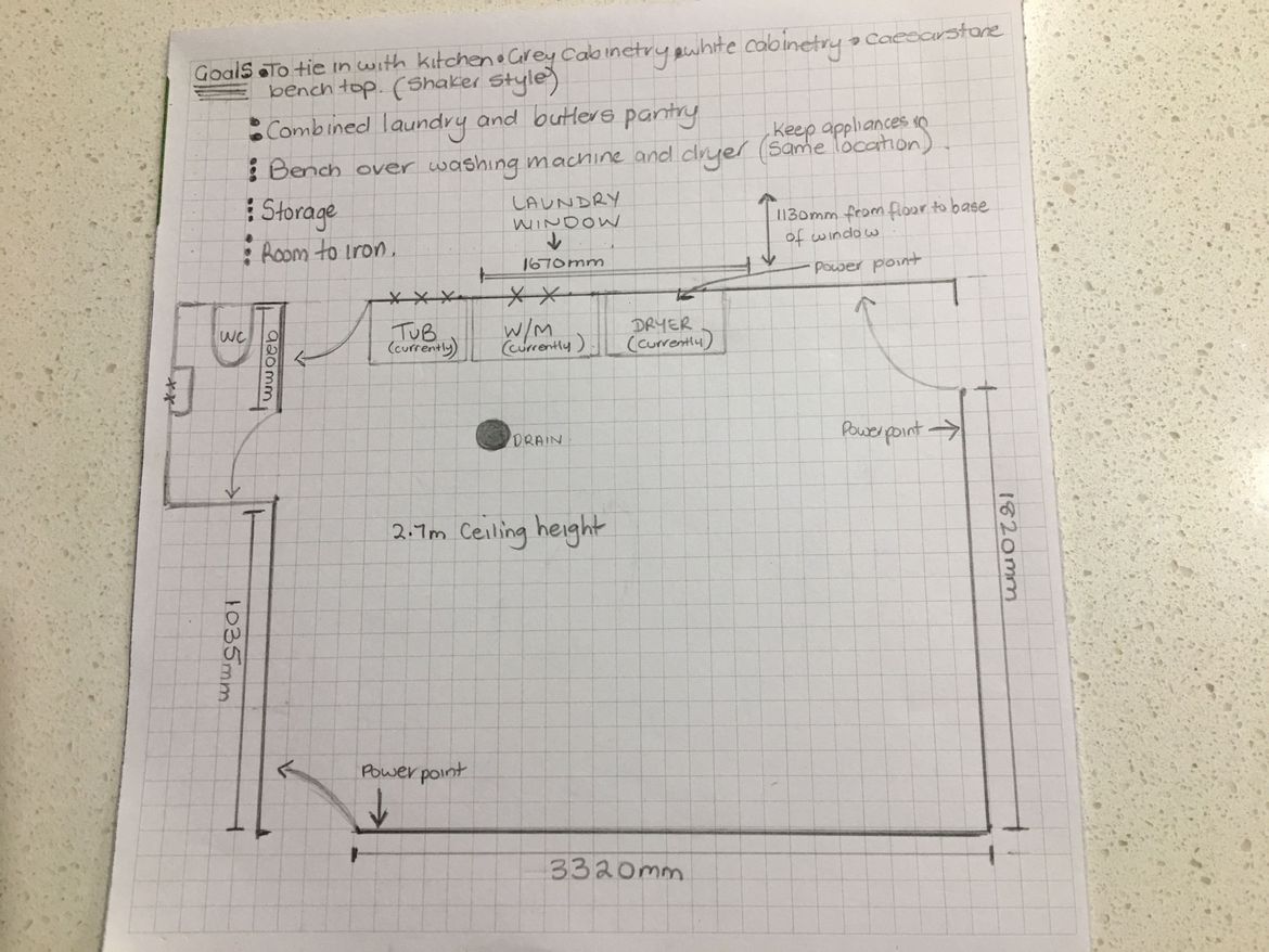

Could we please trouble you for a sketch of the floorplan? It would really help members to see what you are working with. Dimensions would also be really valuable.
And can you please share some of your goals for this project? What do you want to achieve from the renovation? As much detail as possible will really help our members to give you more helpful and specific advice.

Thank you Jason for your suggestion. Hope the sketch can be read? We would like to tie it in with our kitchen colour scheme of grey and white. We Would like to leave the tub, washing machine & dryer where they are but update the appliances and have the pantry & storage on the other side.
Many thanks for the sketch and the extra info @lana.
Let me tag the amazing @redracer01 who might like to share some ideas and perhaps even some designs with you. Very experienced renovators @Mathy and @2Belindas might also like to kick off the discussion with their thoughts.

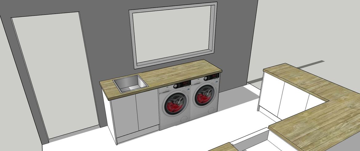

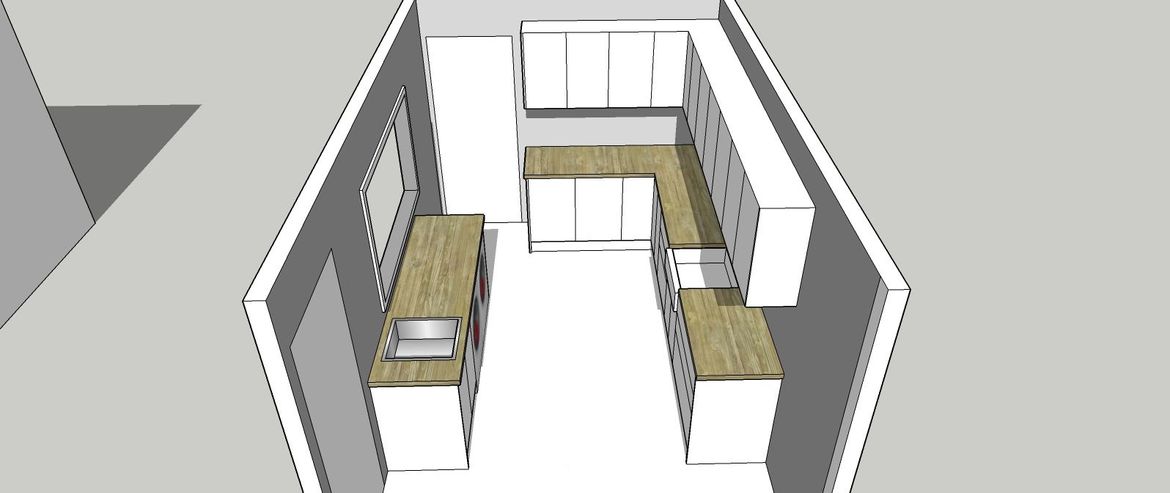

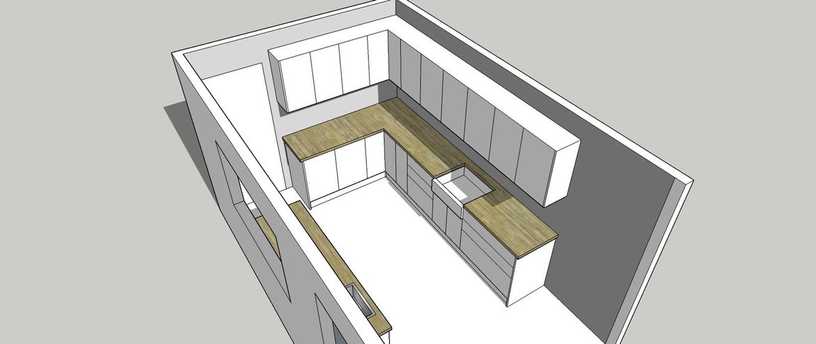

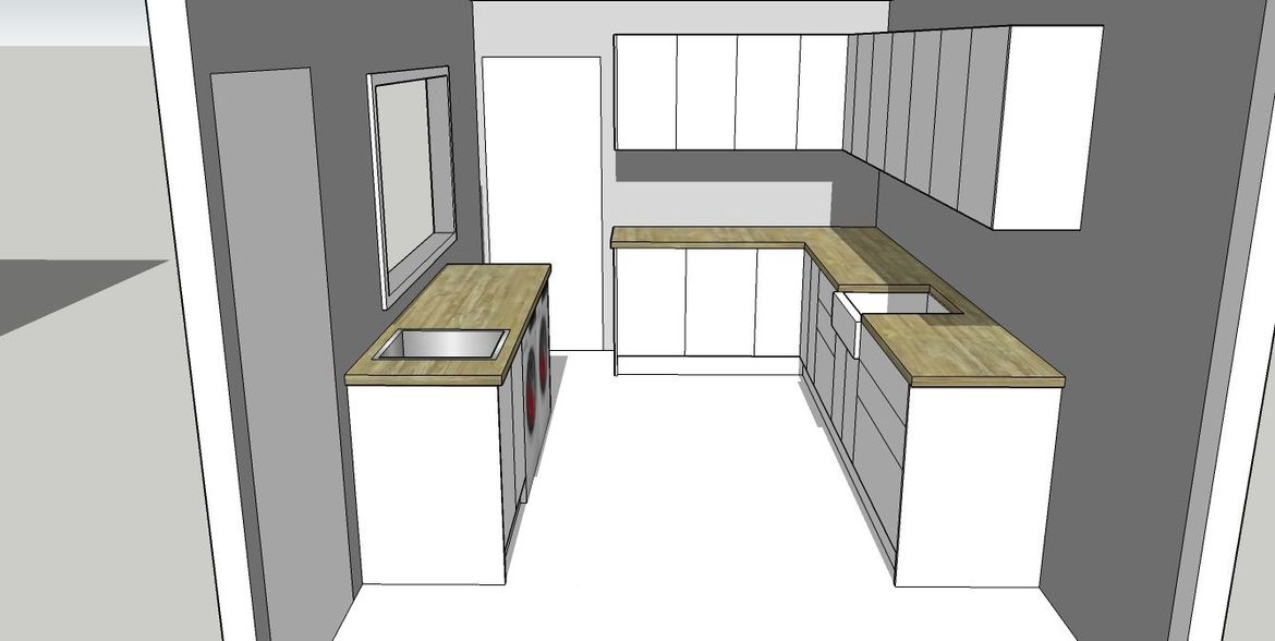

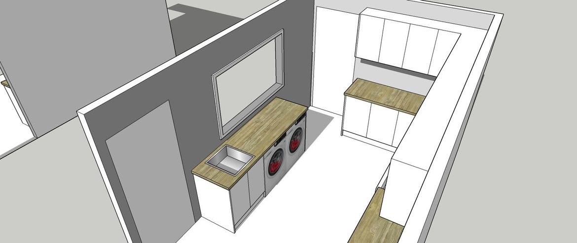

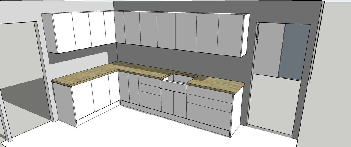

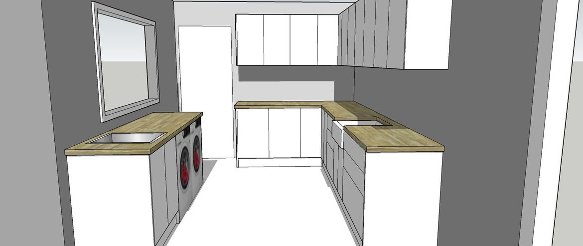

Hello @lana
Doing part of your renovation by yourself is the goal of most renovators to save money. But we must balance this with practical considerations such as plumbing, electrical and tiling. I have attached some drawings for your renovation, this is just to give you an idea of what the layout could be like. You can remove some of the cabinets if there is too many or even replace them if you wish to have a pantry in the line up. The laundry side idea is only possible if you change your washing machine to a front loader. Choose colors that will either blend or compliment the colors you already have in your house. However this is not a fixed rule and is always up to you. Email the drawings to your closest Bunnings store and get a quote! I suggest Think engineered bench tops, easier to maintain, non porous and is easily repaired, with equal if not superior properties of stone. I hope the drawings give you inspiration and I look forward to your final decision on how you will do it.
Cheers!
Red
