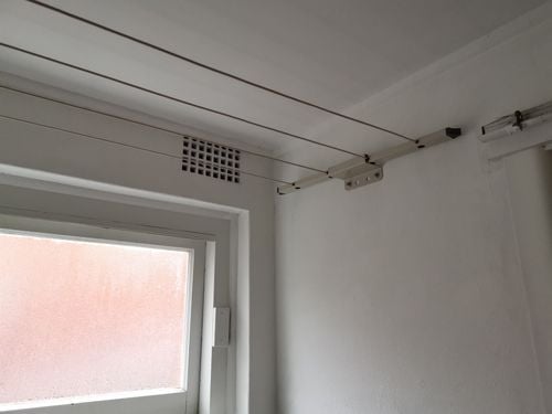

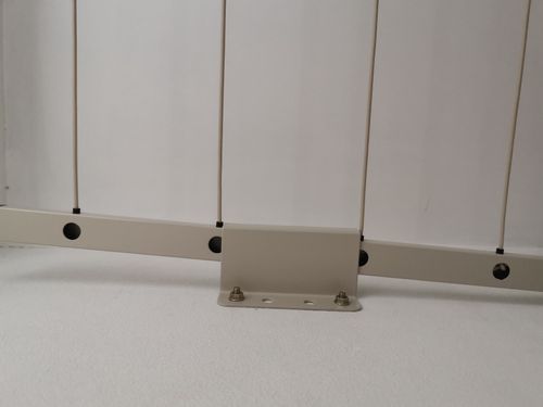

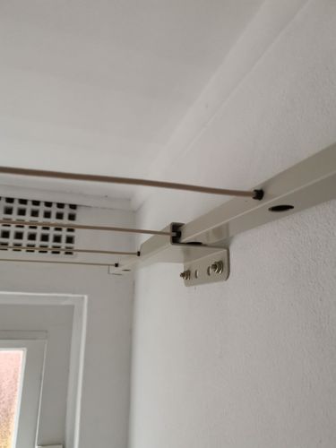

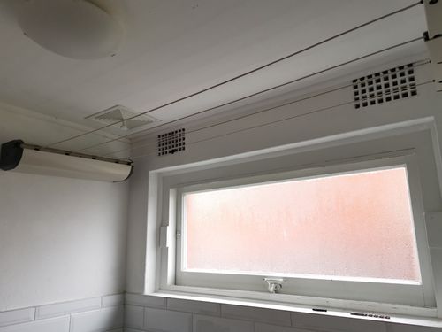

Currently trying to install a clothesline so I started with a retractable clothesline but the lines were either too loose or the tensions of the unit were uneven. (Pics below).
Is there a way to fix the tension so it can be even?
If there isn't, what other alternatives are there? The space I can install some sort of clothesline is 1500mm X 700mm.

Did you have the brand of the clothesline as that would give me a great place to start? Was it the Hills 4 Line Dune Retracting Clothesline as it looks very similar?
Often retractable clotheslines have minimum operating distance. The 1500mm you have is less than the minimum length required for several models I have found. This could be the cause of the issue. However, I would like to speak with the manufacturer first before we look at other options.

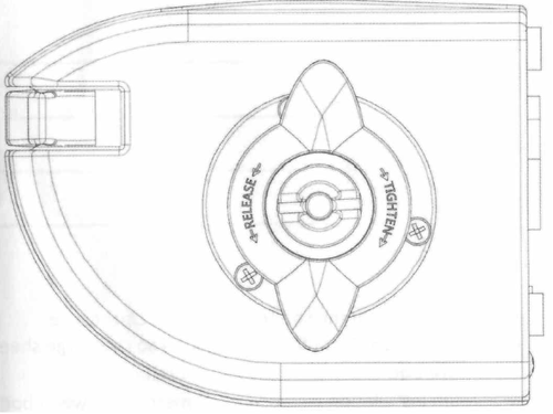

There are a few things I would like you to try to see if we can resolve this issue.
1. Release the tension via the knob on the righthand side of the unit and allow the bar to retract back to the cabinet.
2. Pull the bar out of the cabinet and hook it back into the mount. Ensure when you pull the bar out that it is in parallel with the cabinet.
3. Once the bar is connected to the mount turn the tension knob in a clockwise rotation to increase the tension.
If this doesn't successfully tension the lines evenly I suggest you try resetting them.
1. With the bar sitting in the mount release the tension by turning the knob anti-clockwise.
2. Pull down on each individual line separately to reset the line tension.
3. Remove the bar from the bracket and return it to the cabinet.
4. Pull the bar out again and place it in the bracket.
5. Turn the tension knob in a clockwise rotation.
6. Repeat if line tension is not adequately even.
Please let me know how you go following these procedures.

Experienced Contributor
