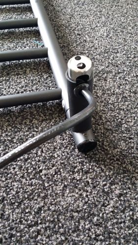

It comes with four screws and 3 bushes and 2 x chrome bushes for different lengths and I am presuming the the one with the side piece opening [in photo] is the one I use for the leg where the electric cord come out .
However I have 2 problems

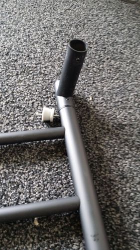

1. it will not fit all the way in to the tube, and I am not sure if I should be putting extra force on it to get it in [I don't want to cut the electric cord with it]
2. it does not have a central hole for screwing into the wall like the grey plastic bushes for the other 3 legs [also in photo]. I noticed this after I had drilled the homes in the wall and placed the plastic expanders in to them]
Advice would be very helpful. plastic bushes
chrome bush
update - I stopped for a cuppa, gave some thought to it and sorted it out, so heated towel rail is on wall and running nicely. ![]()

Hi Mitchell - it was basic really. I screwed the chrome bush on to the wall through the smaller of the 2 holes, saw that it lined up with the others then placed the heater over them all and pushed and it slid in ok. ![]()
Fantastic work @MaryTonnz! That was one of the avenues I was exploring, that mounting the bushings might lead to a solution.
