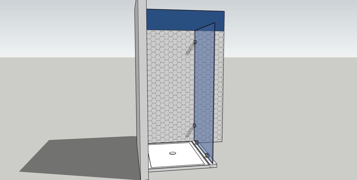

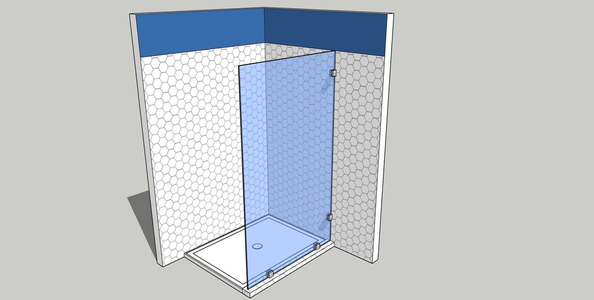

I recently bought the D'LUCCI 10 x 2000 x 865mm Frameless Glass Shower Panel Door Kit; Item Number: 4890736.
I need some advise. I also purchase a shower base from Reece for my bathroom and would like to fit the shower door kit to the shower base. I was wondering if that can be done? Can I fit the bottom bracket into the shower base? I prefer using a shower base rather than a tile base.

Hi @Rach_m - I think we need some photos if possible. The glass door kit mounts to the wall, so assuming you got the right size shower base (870mm as per the Bunnings info for the shower screen) - the bottom bracket should be ok. Thinking you need a plumber to install, waterproof etc., the shower base? This will ensure that the levels are ok for the screen installation. But photos would be good! Cheers Deb

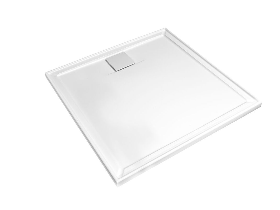

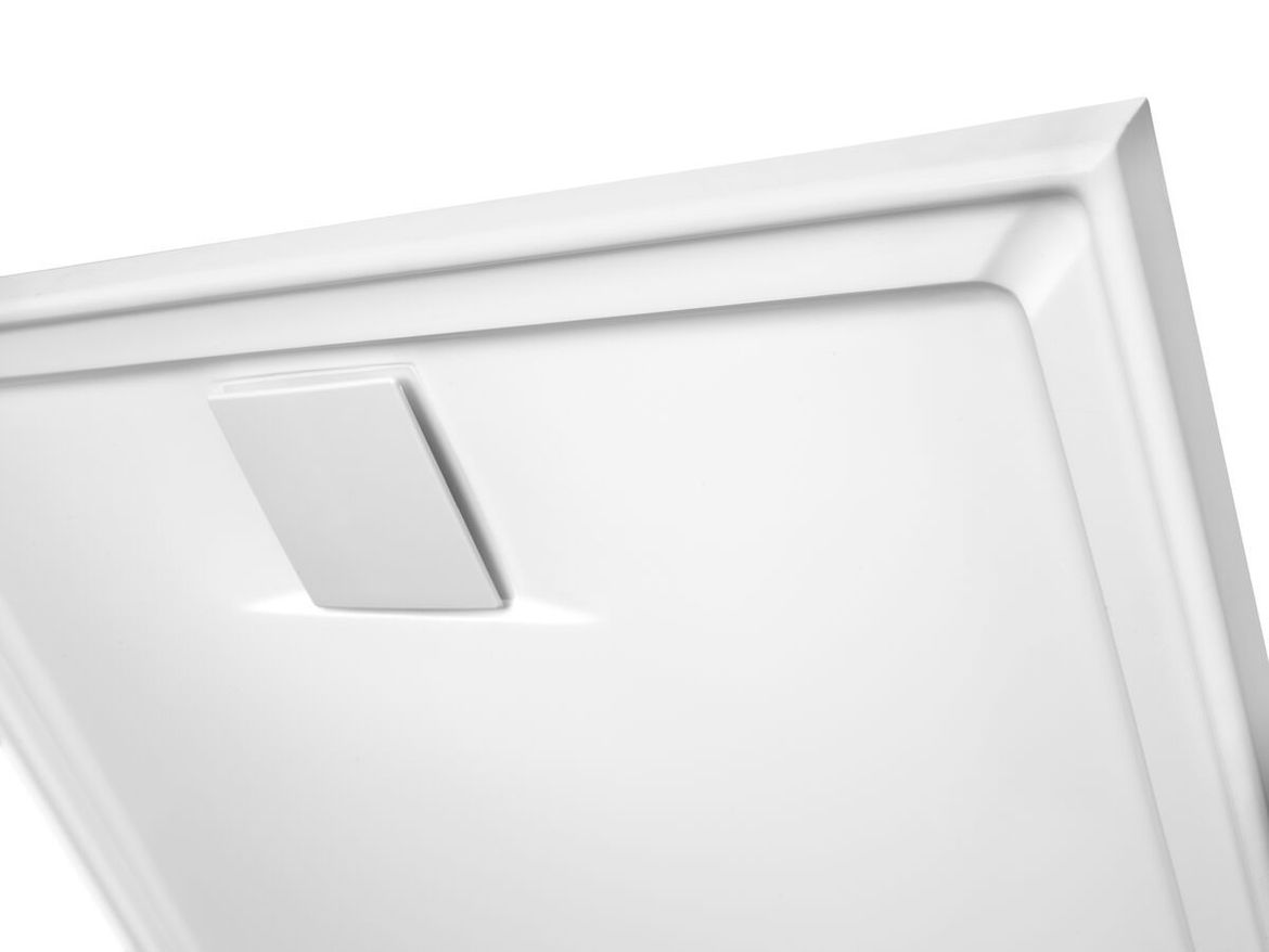

Hi Deb,
This is the shower base that I purchased from Reece.
This is the shower screen that I purchased from Bunnings. Yup, will be getting a plumber to do the install ect, but just wondering if these two items would fit together before getting the plumber in and realise it doesn't. Appreciate your help.

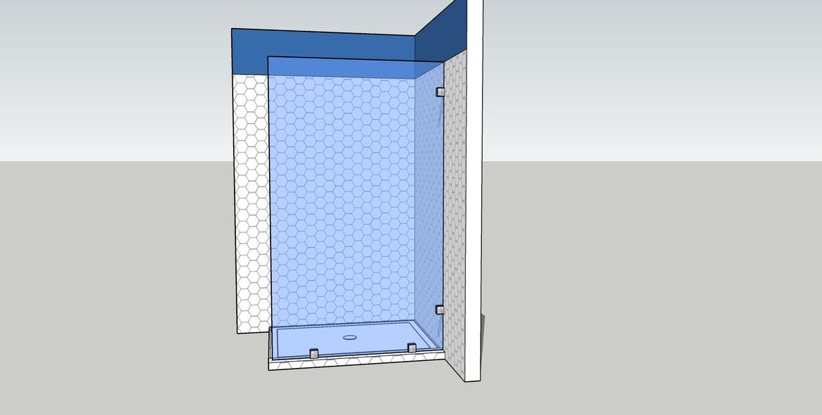

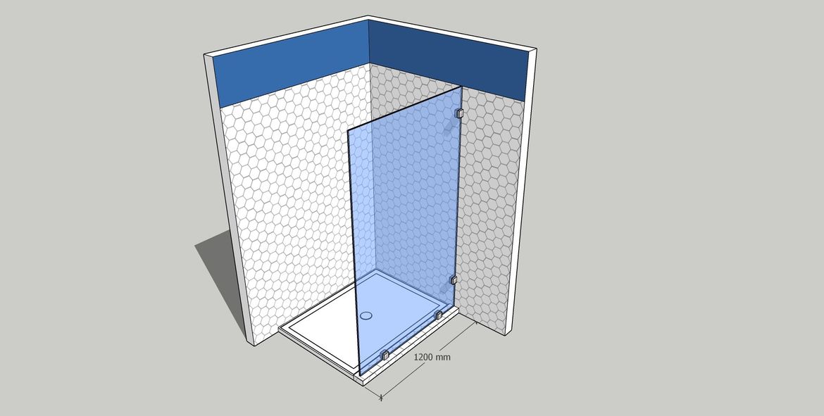

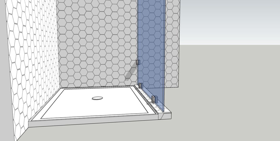

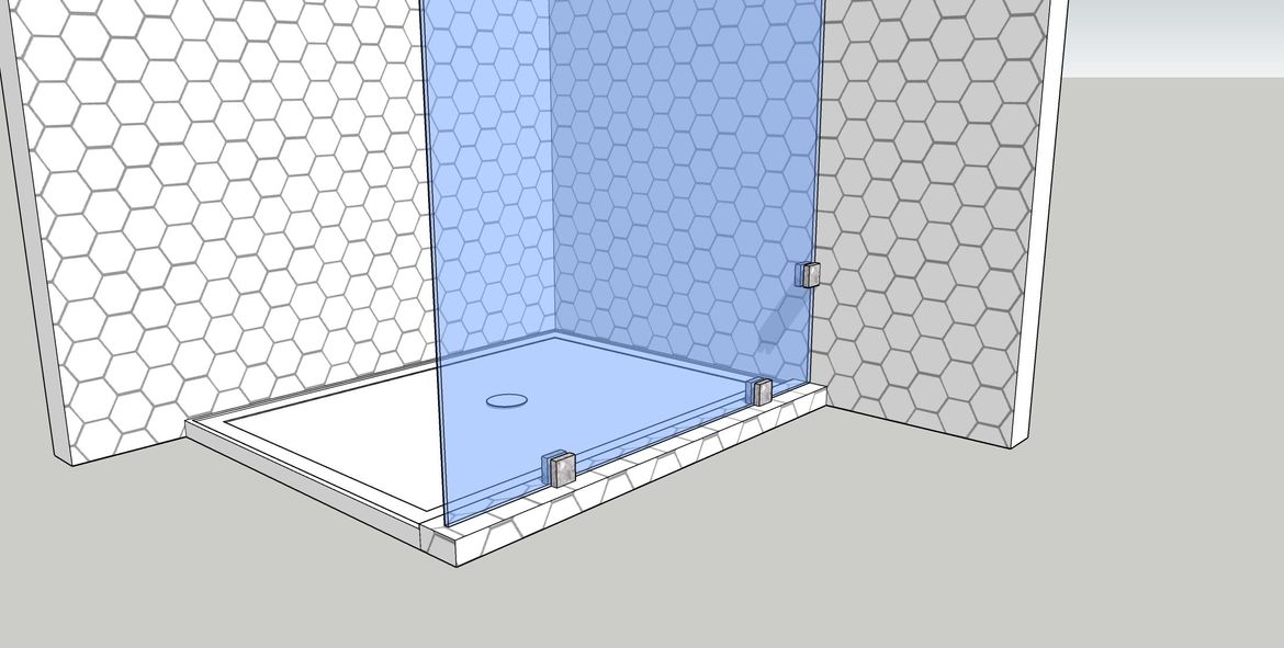

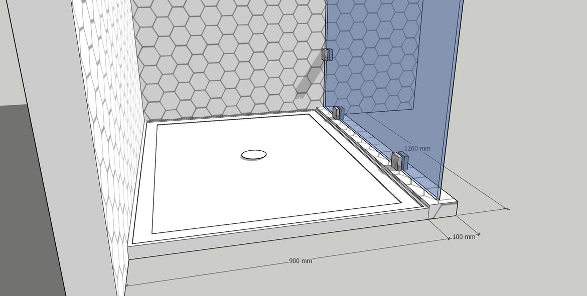

I'm sorry to hear about your shower glass panel installation. Have you thought about building a small cement hob next to the shower tray and covering it with tiles so that the glass panel sits on the cement hob? It will still look visually appealing and you won't have to buy anything special as the glass panel can now be installed regularly. I've drawn a diagram below to give you an idea of how it could be done.
Please note that the measurements placed are for reference only, please adjust them to your needs.
If you have any other questions we can help with, please don't hesitate to post them.
'Morning Eric, thank you for your efforts and nice diagram
.Unfortunately taking another 100mm out and moving the screen over would impinge on the WC location. In addition, even with silicone sealing, we'd be introducing another potential leak area at the hob/tray junction. Aesthetically, I'm not sure that this would be appealing to look at either. I think I will stick to drilling through to the slab under and anchoring with long shaft ss anchors as well as 5mm structural silicone jointing to the tray. I'll review the installation once the silicone is cured and if necessary install either an off the shelf head brace or custom toughened glass brace at the head of the wall junction and maybe in combination with a toughened glass head brace.
Had I'd known that these panels should not be fixed to the tray, I'd have built an insitu tiled shower floor but now I'm stuck with what is built.
