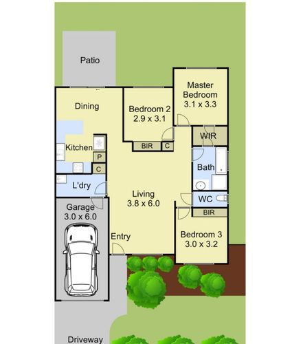

This is a duplex unit, with the garage, laundry and kitchen sharing a wall with the adjacent property. Could a toilet be added in the laundry? Or in the WIR?

From an ease of installation point, I suggest adding the extra toilet in your shower room. Specifically, where the current bath is. The reason for this is that it is right next to the existing toilet which means that there won't be a great deal of digging and pipework laid out.
I propose doing a bit of research regarding the layout of the plumbing services in your house. This will give you a much better idea of where the toilet drain is located and if it is feasible to run pipe work through your house to the laundry. Just keep in mind that going through your house means that the flooring if tiled will need to be cut.
I also recommend engaging the services of a licensed plumber so that you can get a quote on how much the extra toilet will cost.

Mmmmm first question is are you on a solid concrete foundation or a timber beamed floor?
Solid concrete and I would be heading towards @EricL's suggestion.
Timber floor joists and it still stays open to either side.
I would be contacting a couple of plumbers to get a quote, they would definently be pointing out the easiest way to install a second toilet. The sewage work needs to be done by a plumber anyway.

Hi @JustinM An additional toilet could be added only to the WIR side due to the shared wall and your sewage is on that side. I am guess the unit is rendered brick, in which case all plumping will need to be external. It can exit both from the WIR and existing WC walls, but be concealed underground in-between, unless there is a concrete path. In this case it will need to be cut open to access the sewage. You could build a small cavity wall in the WIR to accomodate a concealed cistern, which would allow the plumbing to exit direct out without the need to cut in to the slab. I don't know the type of plumbing the existing toilet has, but in any case a licensed plumber will be required to do all the work, with exception for the new toilet cavity wall. Though some plumbers to do renovation works.
If you have underfloor access then the Jobe will be much cheaper and easier and you can utilise standard cistern toilets.Hope this helps. Nailbag
