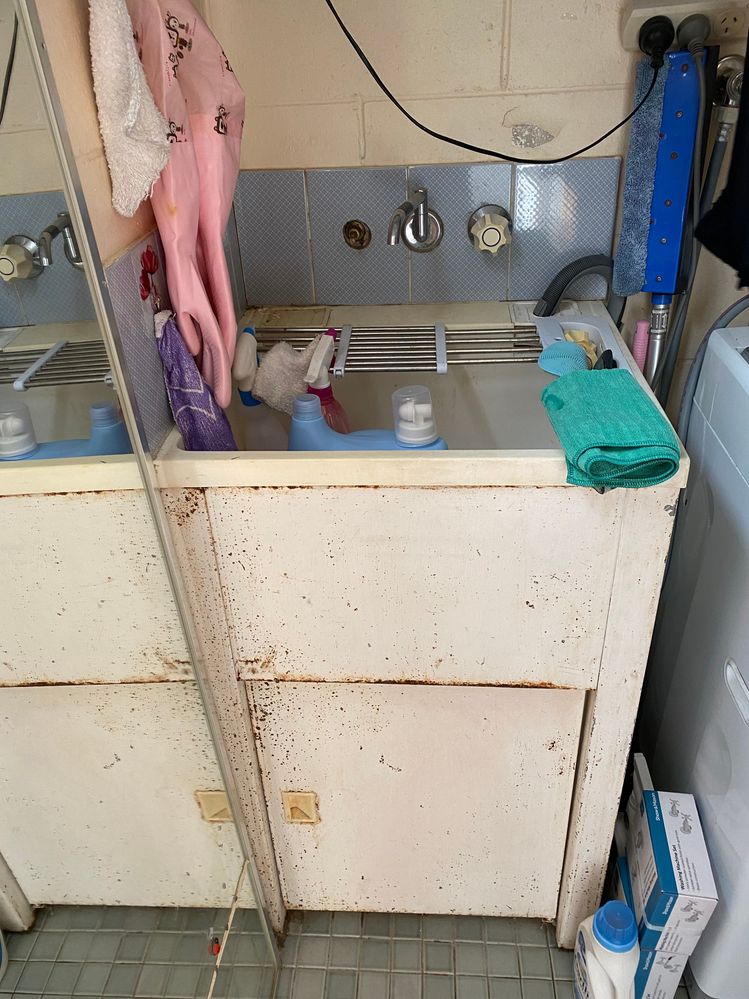

I have an old rusted laundry cabinet and I was wondering if it would be worth my time and energy to revive with it a CRC Rust Spray gel or something similar? The rust have been there since I moved into the apartment 8 years ago. Would it require a lot of effort to try and remove the rust or would I be better off just replacing the laundry cabinet altogether? As it would be ideal to save a bunch of money without having to replace the entire cabinet. But how long would it if at all be effective to remove the amount of rust on my laundry cabinet? (Someone had chucked out their laundry cabinet and I picked it up thinking that I might wanna replace my old one with this one. What do you think? Should I just replace it with this one instead? see 1st pic))

The ongoing debate whether to restore or replace a certain piece of appliance has been a long-standing discussion. In your case sanding down the rust spots and repainting the steel body is one way to restore it. But how long will the repair last before the steel body starts to rust again?
On the other hand, replacing the whole tub means that you'll get a fresh new appliance that should provide several years of extended service. But it will definitely cost more than a restoration project.
However, if you wish to restore your tub, the only thing I would watch out for is large areas that are no longer recoverable. It means that the rust has eaten through the cabinet walls and feet. If this is the case, then it would be more practical to replace it.
The general steps to restoration are to sand down all the rust off the body, give the entire body a sand down to rough up the surface. You then wipe the entire surface with sugar soap to remove all the sanding dust. I suggest using the White Knight Rust Guard System. It has a four-step process which is to clean, treat, prime and topcoat the steel cabinet.

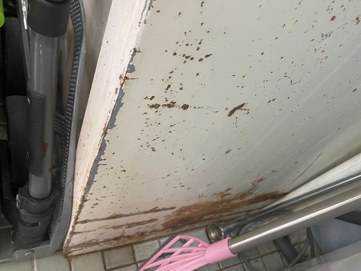

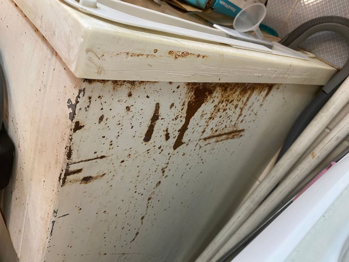

The side rust and scratches dont look too bad and potentally you could bring it back. That lumpy top of the sink tho looks like it could have gone too far. You could try and seperate the sink from the base (I remember struggling with dismantling mine, especially with how the previous people had attached it to the wall lol Then see if the rust has gone through and repair as @EricL has suggested.

Thanks for the reply! It has helped me! I have decided to go with replacing the tub.
