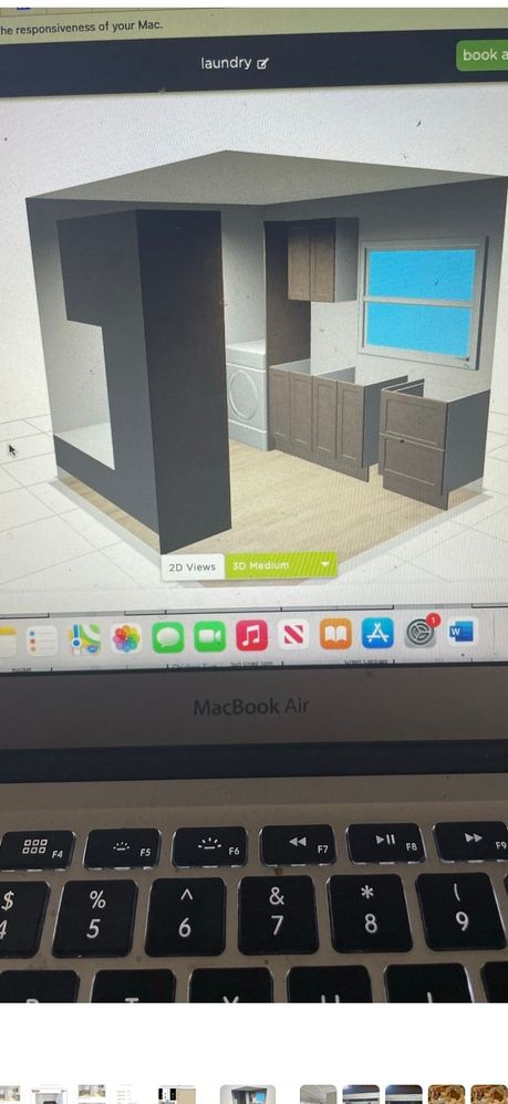

Planned the layout and took measurements.
we used the kaboodle planner for this  to test the cabinetry and see what would work best.laundry design online.jpg

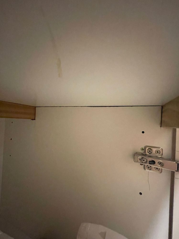

Assembled the flat pack-
we built the cabinetry ourselves and used a 600 units for the sink , but held off fully assembling them so we could modify them to fit.cabintry laundry ...jpg

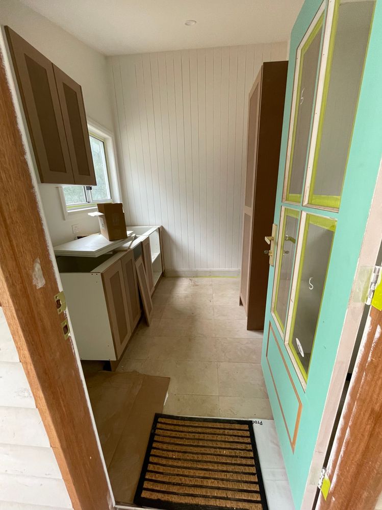

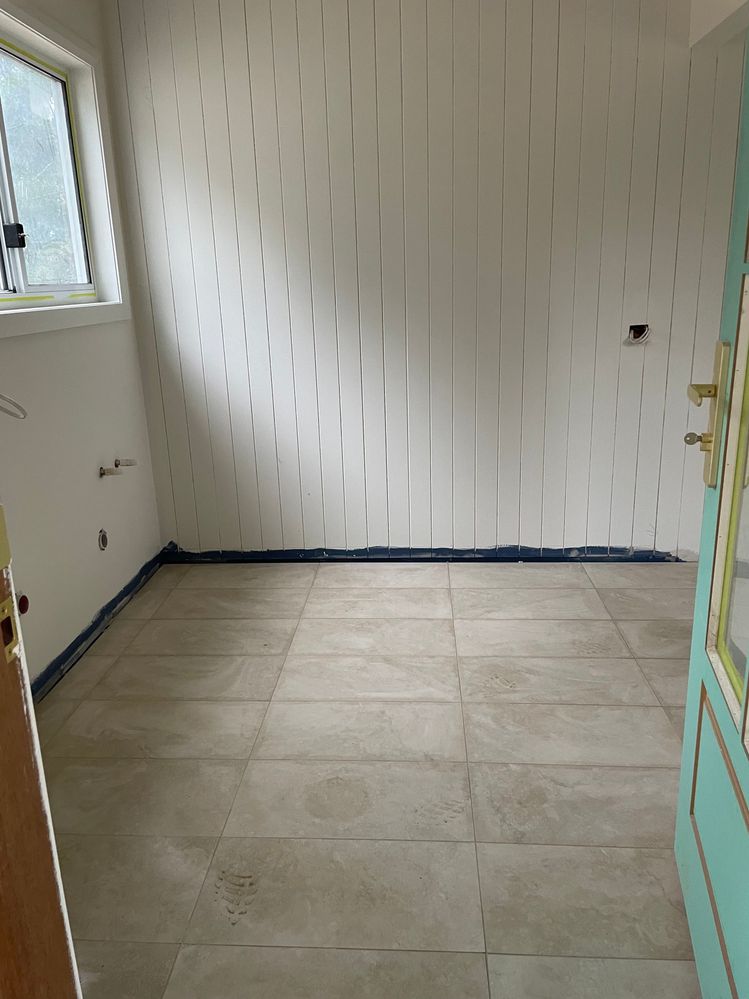

I will add the vj panelling was installed when flooring and watering proofing was invj panelling.jpgstalled..

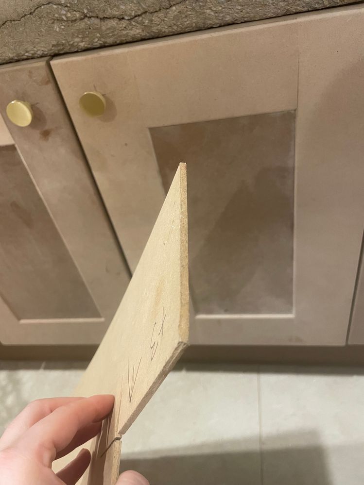

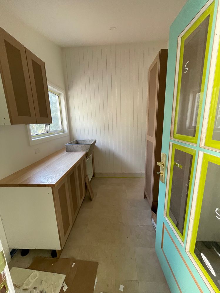

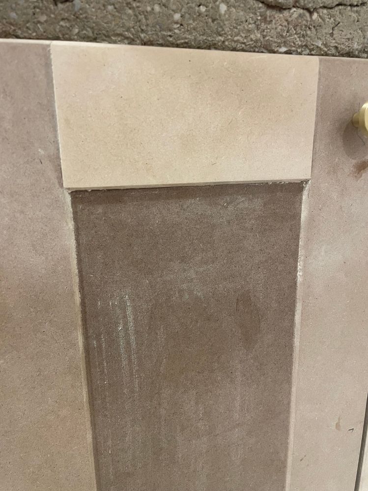

created the DIY shaker style doors-
we cut the tops off these doors for them to fit, then Cut 3mm MDF into stripes the glues them on top of the existing door to mimic around the shaker style doors. once glued we sanded and smoothes the edges. we customised a 600 cabinet unit and used two 300 doors so the sink would fit perfectly.. this was the best photo explain this I have.custom 600 cabinet.jpgmdf door snaded.jpgmdf picture.jpg.
Step 5

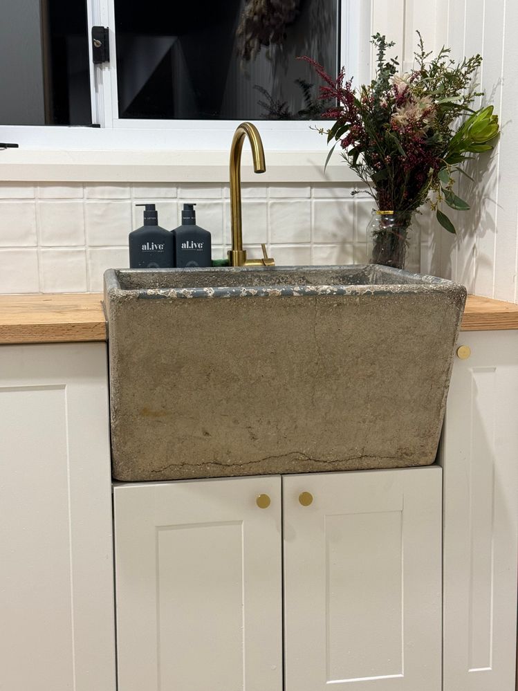

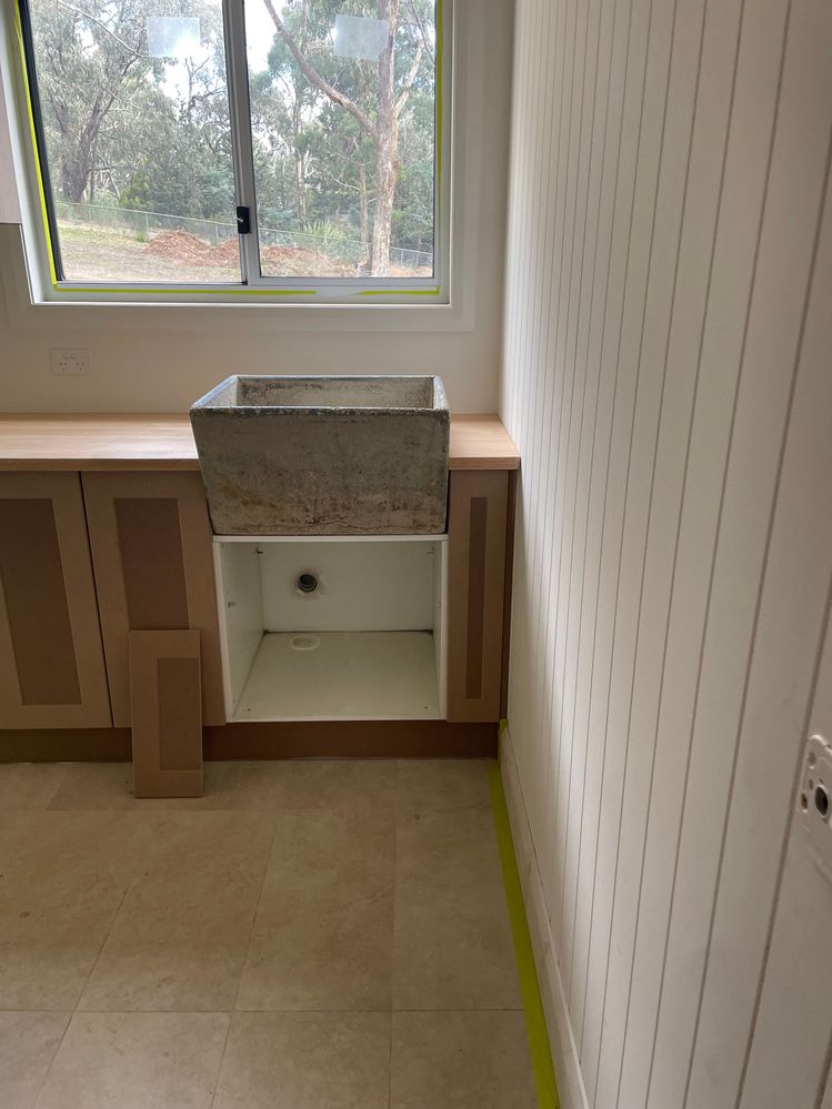

installed the oak timber bench top, oiled it and installed concrete trough...
we installed the bench top , oiled sanded and oiled and then installed the concrete extremely heavy concrete trough .trough and benchtop.jpgtrough and benchtop 1.jpg

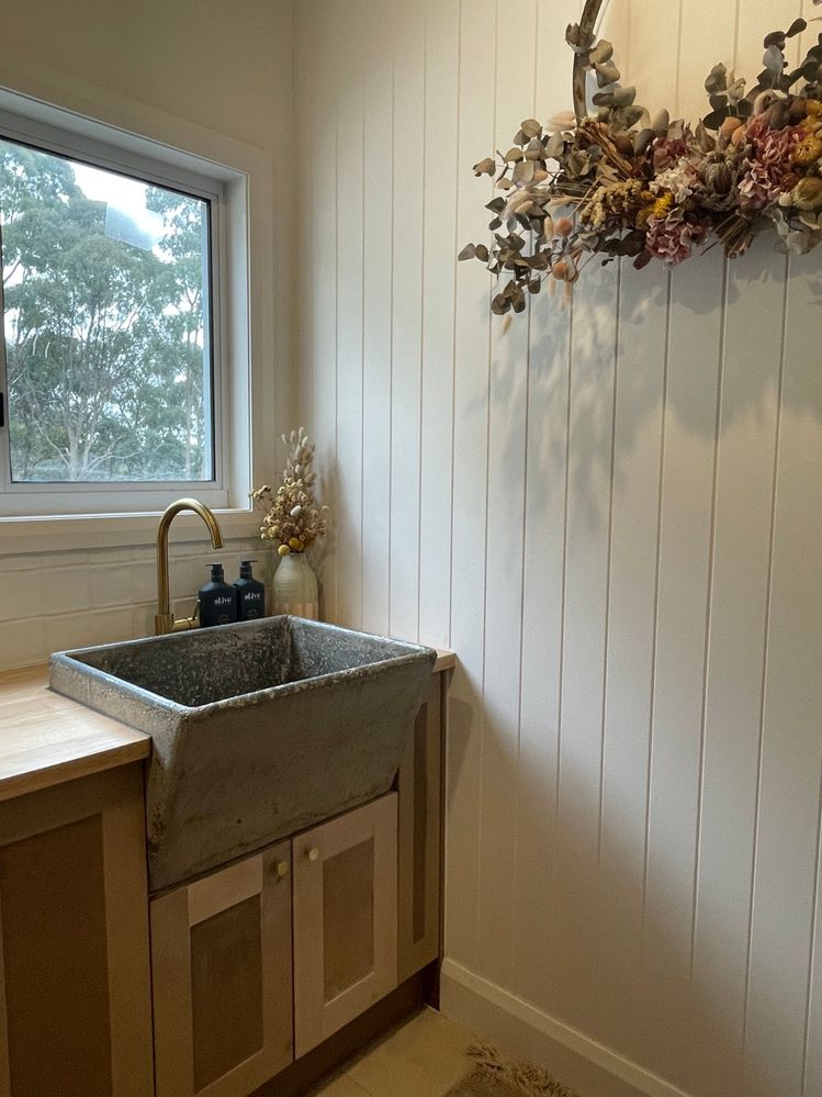

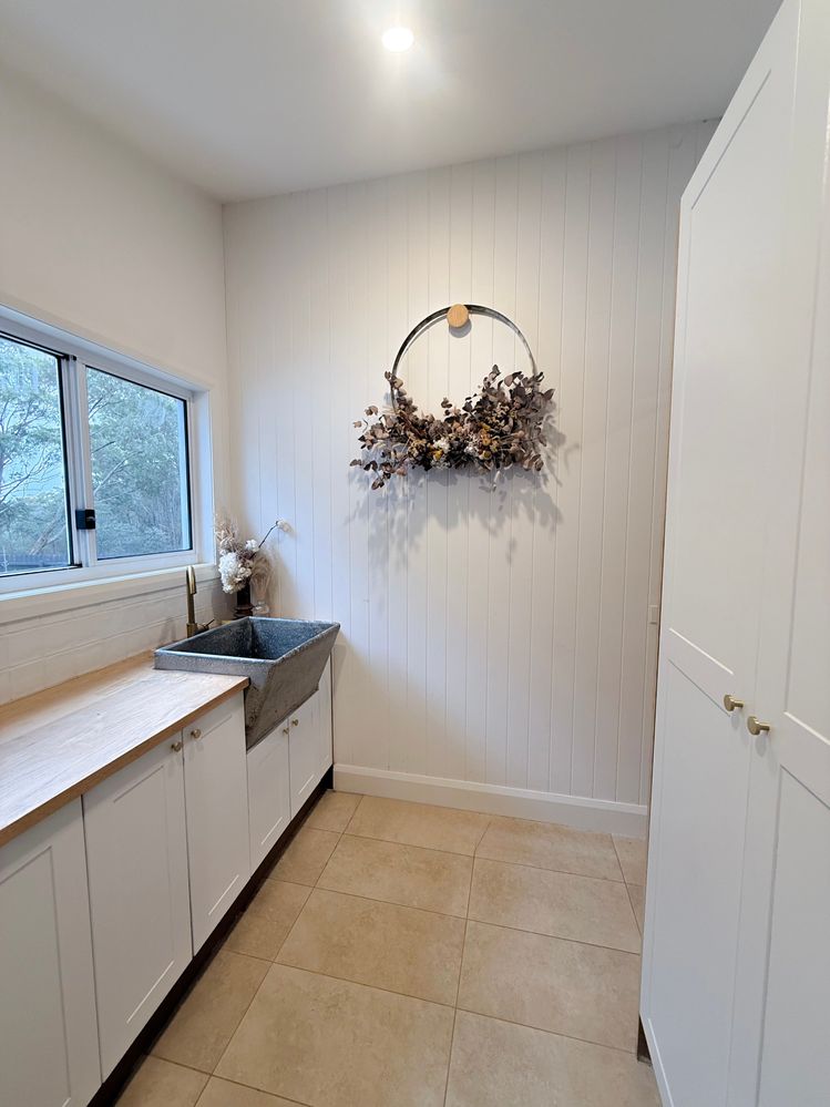

The plumbing was fitted off, and then we primed and painted the cabinetry.. Using a bonding primer and then two coats of dulux natural white and doing a light sand between each coat.. resulting in a smooth finish..before paint trough.jpgfinished trough.jpglaundry.jpg

@PaulineHawker @PaulineHawker Your laundry looks gorgeous! Simple, timeless and home-y.  Can I ask which paint colour was used on the VJ Panelling?
Re: Laundry reno inspired by concrete trough
Welcome to the Bunnings Workshop community @teganavis. It's sensational to have you join us, and great to see you've been inspired by this project.
Do you have your own laundry reno in the works?
We look forward to hearing about all your projects and plans around the house and garden. Please feel free to reach out anytime you need assistance or have something to share with the community.
Used dulux natural white @teganavis
Thanks Pauline. I was'nt sure if you used the same colour on panels as cabinetry, as the panels appear to be a different colour in some of your photos. Must be the lighting 😊 Beautiful work!
