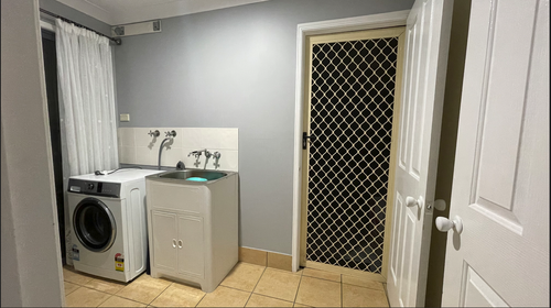

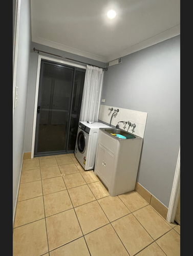

Our laundry was pretty basic with just a standard trough and little storage. We wanted to make it more practical and use all the space for storage.
We have used all the supplies from Bunnings and hired a plumber from Air tasker to shift the connection. Only sink and tap were sourced from Amazon.

@rachitshah My laundry is very much similar to what was your previous laundry.
I would like to put Hybrid Floor as well. You reckon that has to be done before installing and after decommissioning everything from there ??
Also, at what stage of renovation you called plumber to shift the taps ?
If you look at my pictures above, I would also like to shift Plumbing point and may be add another electrical outlets under the table for washing machine and dryer. Any advice here.
Also, did you put the benchtop and sink yourself on top of cabinets ?
