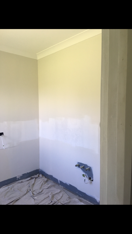

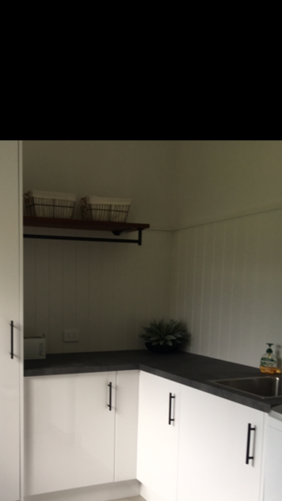

The laundry needed to be updated prior to moving in. My dad is very handy and together with the help of one of his mates we transformed the space into a beautiful laundry. A wall that once housed a copper was removed, restudded & lined. Kaboodle gloss white cabinetry with Basalt benchtop was installed. Shelving was cut from a Merbau FJ panel. Bellazza Creama porcelain floor tiles were laid.

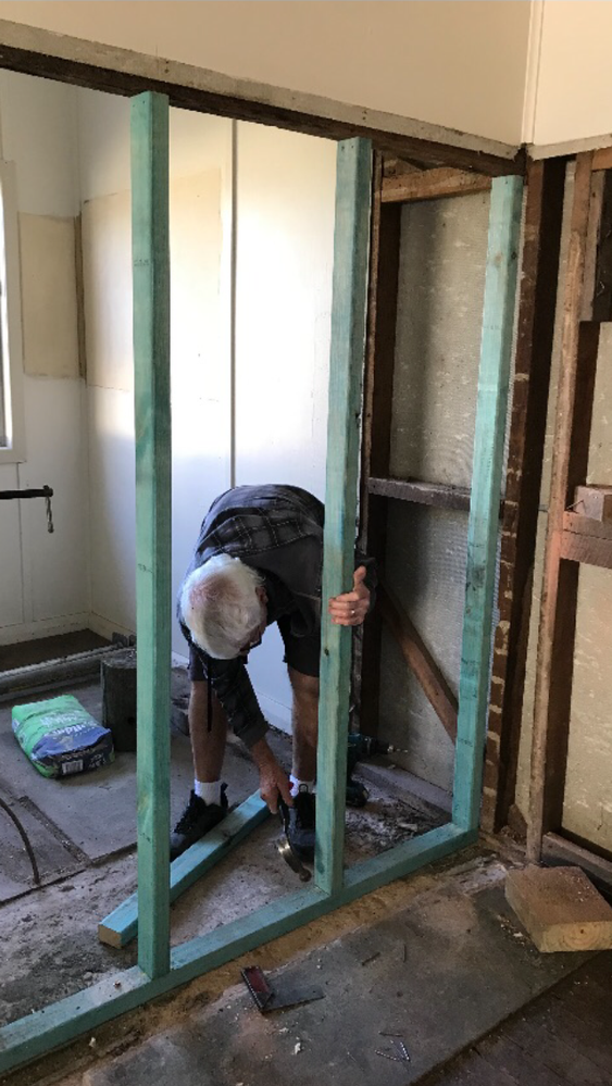

Restud wallRestud wall
Step 3
Reline wallReline wall

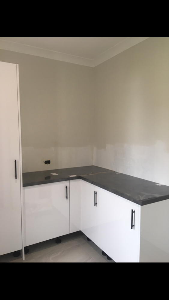

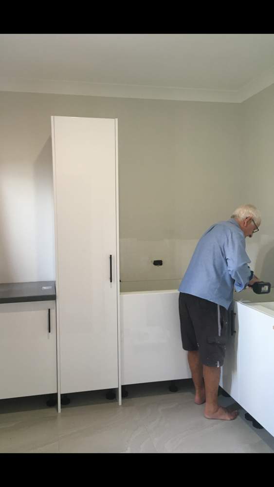

Install Kaboodle base cabinets & gloss white modern panels. T Handle T/Master Matt Black handles fitted.Install Kaboodle base cabinets & gloss white modern panels. T Handle T/Master Matt Black handles fitted.
Step 5
Basalt bench tops put in place ready for sink cut out & installationBasalt bench tops put in place ready for sink cut out & installation
Step 6
Nugleam Everhard sink installedNugleam Everhard sink installed
Step 7

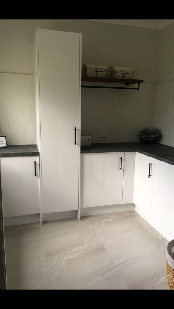

EasyVJ 100 Panelling added & shelving cut from a piece of Merbau FJ Panel to also create a hanging spaceEasyVJ 100 Panelling added & shelving cut from a piece of Merbau FJ Panel to also create a hanging space
