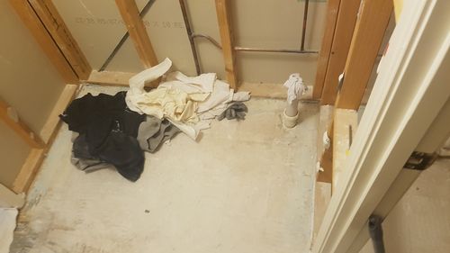

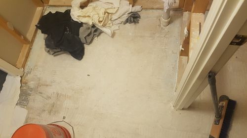

Hi All,
Im in the process of renovating my laundry room and would like to do all the preparation work for the plumber to eventually do. I need to cut the subfloor to open it up for the plumber but im worried I may not be able to just cut a small section without having to replace the whole floor. So the question is it is possible to cut out a small section of the floor and also replace that with an equivalent after the work has bern completed. Or will i have to remove the whole subfloor for the room?
Intent is to get the plumber to connect the floor waste to the laundry sink waste. So if the washing machine leaks or anything there is somewhere for the water to go. 

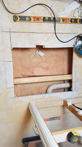

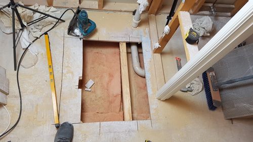

Thanks for your help Mitchell,

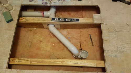

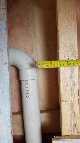

As you have right fully mentioned, I opened a section of the floor and it looks like I will need to run through the one joist then connect to the sink drain. It would  be simple to have the floor waste parallel to thr joists however it would look off centrered when the job is complete. So might have to cut through the joist.
Re: Laundry renovation
Hi @BryceBrad,
You'll need to go through the joist as the drain has to be somewhat central in the room so the floor can be graded towards it. The easiest access would be to run the new pipes as I have illustrated below, however, I would prefer them to go a more direct route noted with the arrows. The more direct route marked will be a little more difficult to achieve as the join will then be under the partition wall. It would be great to chop the right angle corner out and replace it with a T joiner there, but by the time you remove it, there is not going to be enough pipe length left to glue in the new T connector.
In any case, I trust it will be little to no hassle for a plumber to connect it up for you. You might want to wait for them before removing pieces of the joist as it won't necessarily suit the layout they'd suggest.

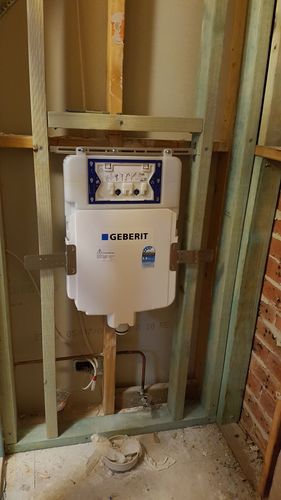

Update to the laundry renovation, the floor waste has been roughed in and soon to be closed so work can be done around the area safely. The framing for the hidden cistern has also been done and will be ready for the plumber to do in one hit hopefully.
Roughed in hidden cisternRoughed in hidden cisternRoughed in new floor wasteRoughed in new floor waste

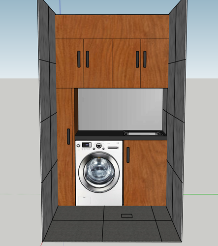

Im stuck between picking the tapware. Currently the taps are wall mount. The advantage with this is that there is more space which would be normally be taken up by the tap if it was mounted on the bench. Also means less cutting of the proposed concrete top and the splashback would have no interuptions. However the bench mounts mixer taps seem to be more modern. However, they dont seem as robust as the traditional taps. Any opinions? Attached the model with what I intend on achieving without the taps.
Machine washing taps would be located under the bench and depending on what option I go with it may end being one of the following.

Proposed layout
Model of LaundryModel of Laundry

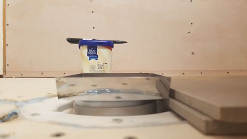

Hi

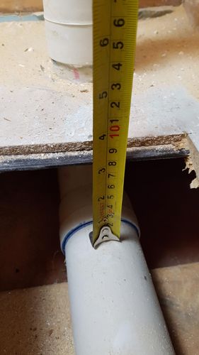

Is anyone able to advise if I am doing something wrong here. Bought two floor wastes and they both seem to be too high. Is there something I need to do?
Seems higher even after adding two tiles. I can't go higher because the floor has to match the adjacent floor. Im thinking maybe the underlay should have been thinner. However, dont think it comes in any size other than 6mm.
Hi @BryceBrad,
Your waste pipe height needs to be set to accommodate your drain grate thickness. The section that retains the grate on that floor waste is too thick and would require the connection to the waste pipe to be much lower down. You'll note that grates like Kinetic 100mm Chrome Brass Square Floor Grate are much thinner and more in the realm of where you must be. This might be a case of the plumber presuming you are using an older style floor waste and setting the height to suit.
