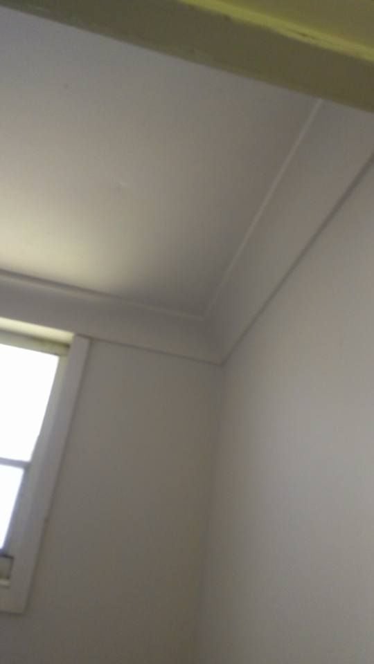

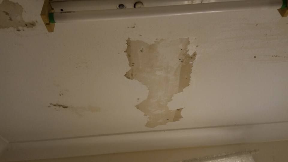

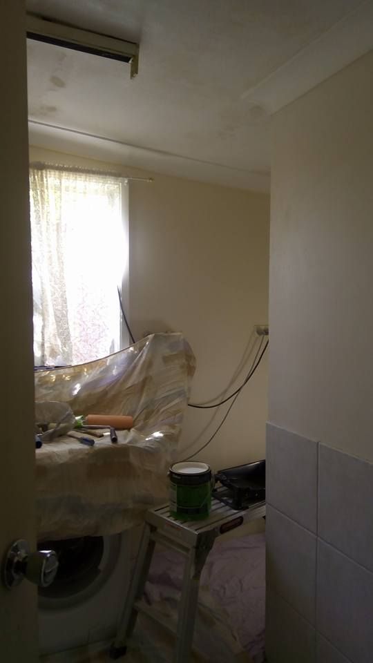

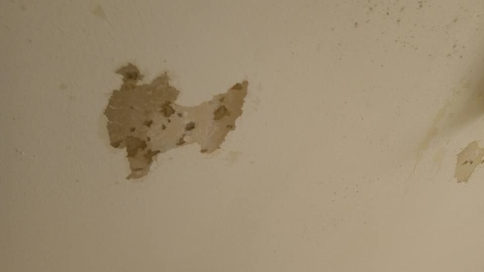

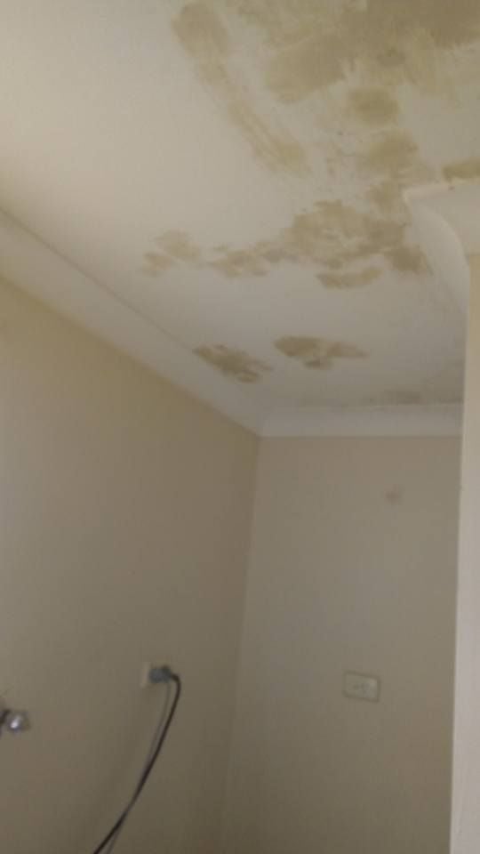

The first step was to repair the crazing of the ceiling. Moisture and a bad paint job previously had caused the paint to crack and peel. I scraped all the loose flaky bits off and then sanded smooth the edges. Once I had done that I filled in the paint height difference with an interior filler. I did this in 2017 and its still going strong 6 years later. No signs of cracks or puckering. The darkness in the photos is from my poor phone camera and the old lighting not working.
Really didn't want to replace the ceiling so thought I would give it a go to clean it back and repair. At this point I wasn't thinking about replacing the light.

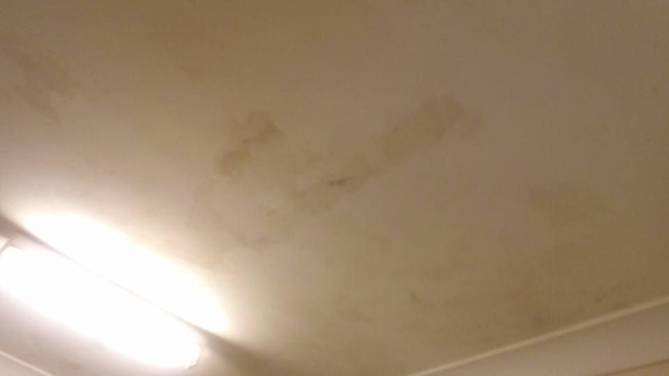

The paint had peeled from the surface in huge flakes.
This would have been directly above the dryer with the previous owners.
I kind of regretted starting it as my arms would ache like crazy from working over my head.
Once scraped clean and sanded I filled in the dips with a fine putty.
This putty worked extremely well and was incredibly easy to sand.

Time to start the painting
So much nicer.
Painted the walls and you can see the old cream colour really show up.

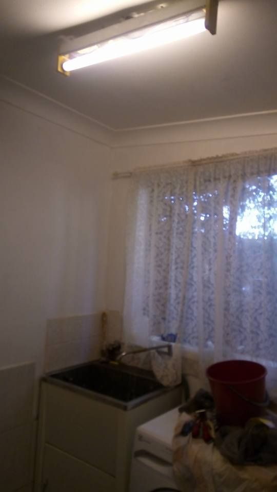

Yeah the light had to go.
Much brighter and clean feeling.

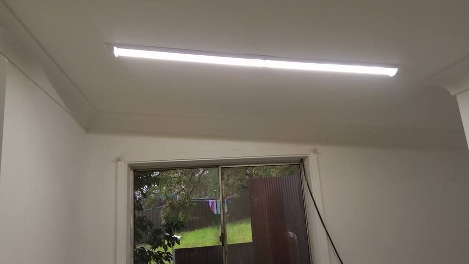

Found a very low rise LED light.
Seriously didn't realise how bright it was going to beam. The Future is so bright I gotta wear shades comes to mind...

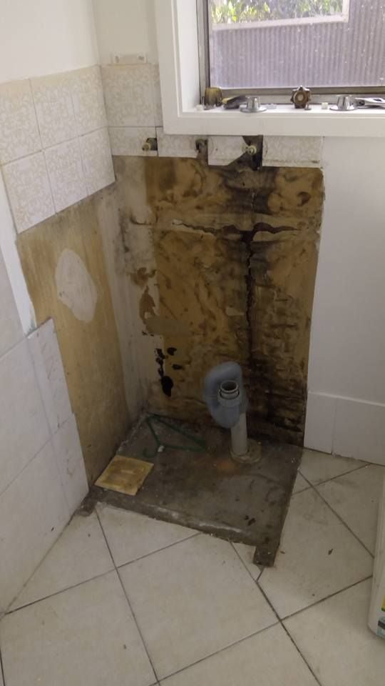

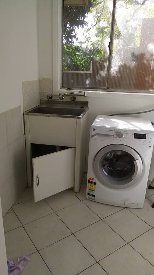

Old laundry sink is about to go.

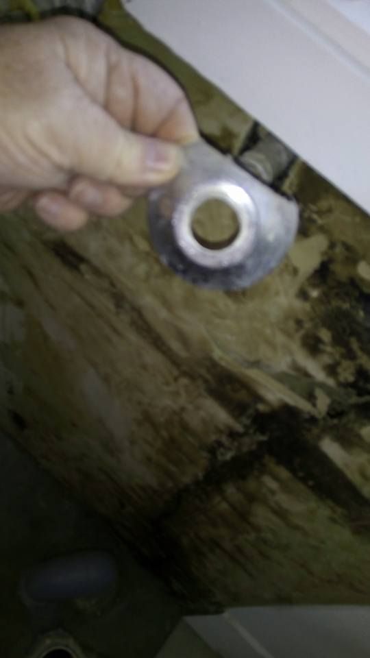

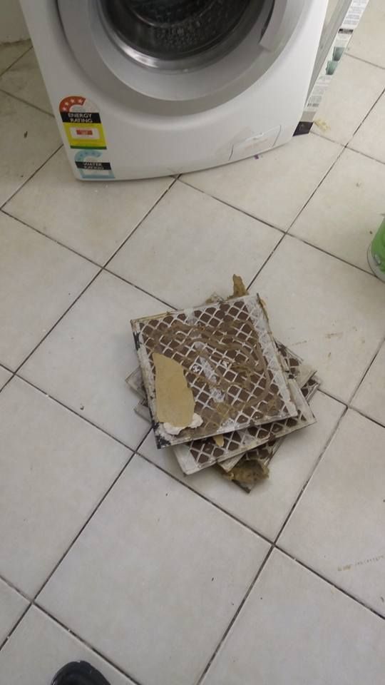

It was a pain in the neck to remove. The previous owners had tiled over the flange on the back side of the metal sink to hide the damage to the wall. I couldn't see any screws and could not figure out for the life of me how it was still staying attached. Once I looked closely I started shaking my head. You can see the long term water damage that had happened.
These tiles were covering the water damage.
Dodgy bro inc strikes again.
The cowl of the tap had been cut with a grinder to make it fit..... My head boggles.
You can see how close the taps are to the window trim. I removed all the old "Water check" material that had been used in the wrong place.

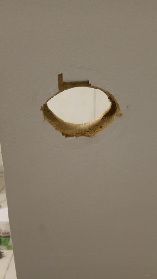

I removed the old door handles and then realised the new ones needed a different centre cutout... Ugh. Looking back at it I could think of a few different ways to do it other then filing and trying to drill it out..
Testing out to see if it fits.
What the hole ended up being 😲

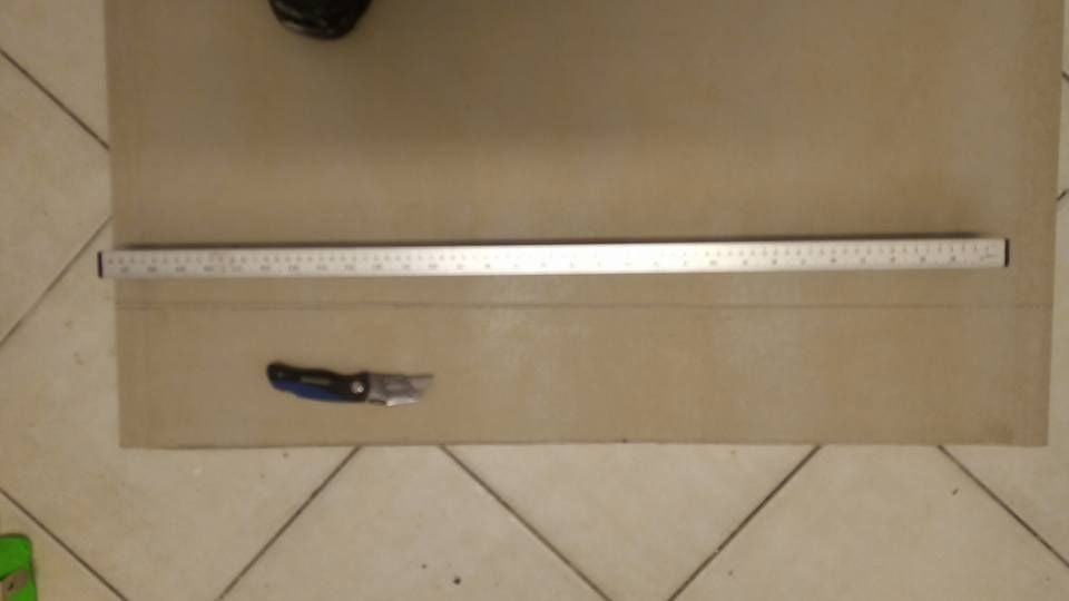

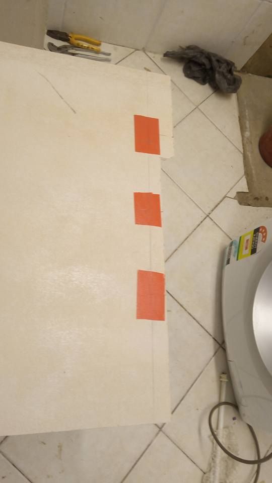

The sheet of villaboard I was using, I had to cut it to size and also cut a section out of it. The instructions I received from Bunnings worked so easily. Like cutting/scouring/snapping a plaster sheet.

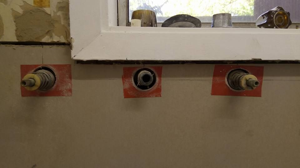

Once trimmed to size I had to drill the holes for the tap fittings. I used a diamond bit hole saw
Sorry for the blurry shot but I was cheering as the holes were true to location and worked so well.
I put down tape so the drill wouldn't want to "travel" so easily. There is no centre spindal on these type of drill bits and I had not used them before.
Like a bought one... I am still smiling even 5 years later!

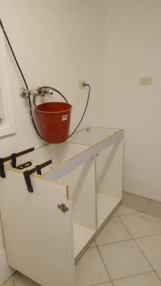

Slow dripping was annoy so came up with a temporary solution
Old carcass before the trimming

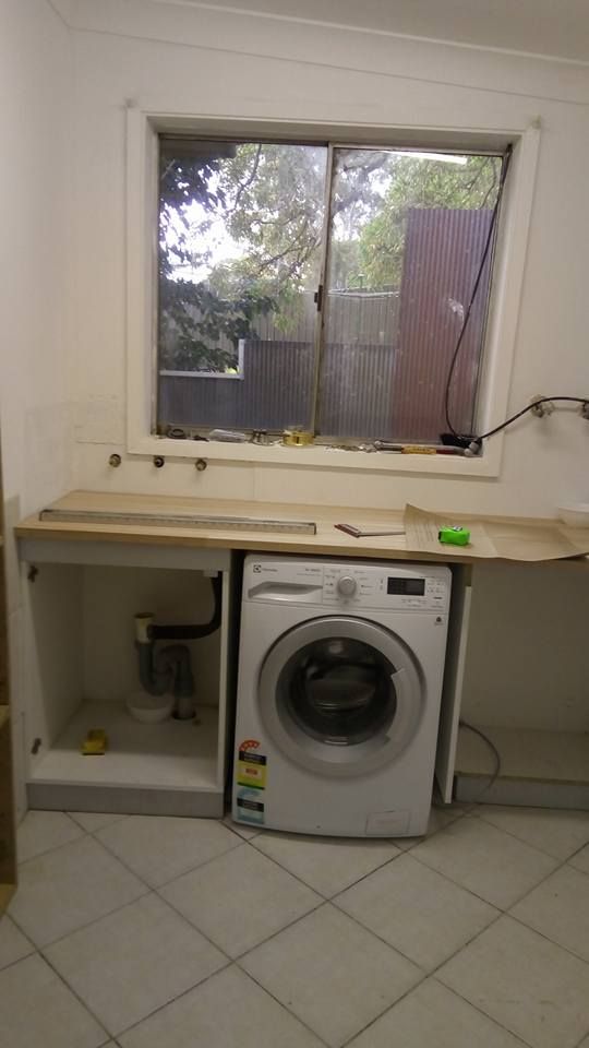

Slowly getting the pieces placed as I wanted them. I made sure I left more space either side of the washing machine in case the next model bought might be a different size. I left 80mm all up extra
The new revamped width. I didn't want to put doors on these as there is really no space to be able to open them and its a Laundry so shelving I thought would be a good workaround.

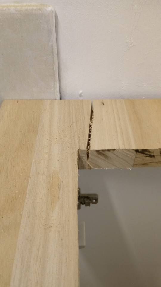

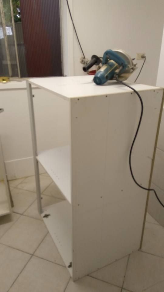

Cutting out the hole. Really should have taken the whole piece outside to cut as almost had an injury being in a confined area. Rem the circular saw can "KICK" you can see the mistake on the left hand side of the hole.
The kick of the saw as it bit into the timber. Need more practice or how to lessons. Silly mistake
I didn't go all the way through but could have been me because I didn't take the timber outside to cut. It can be filled with timber putty so all good but blood was pumping.

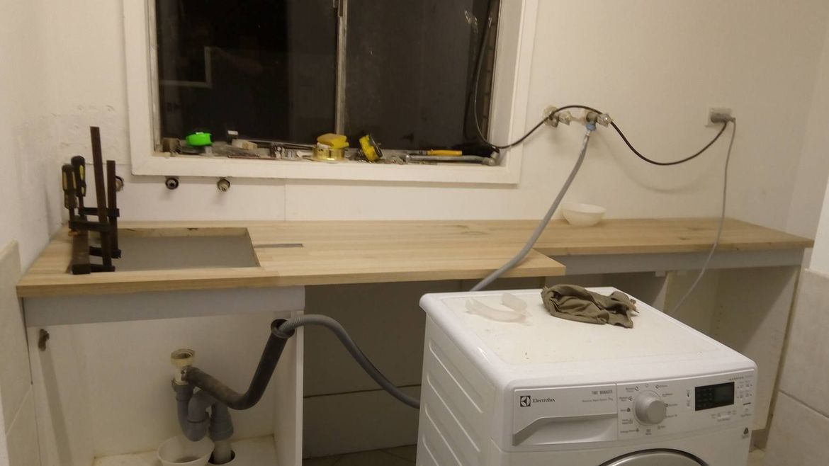

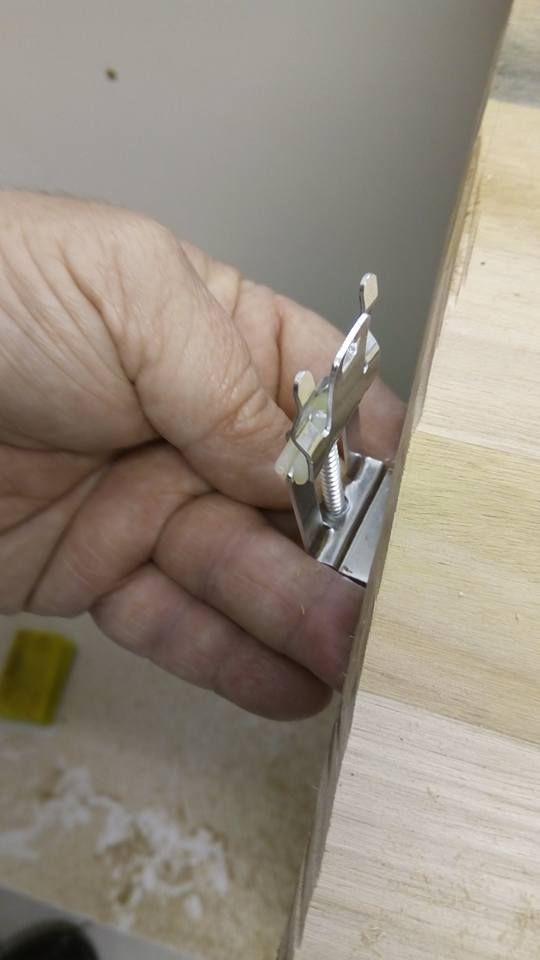

Trying to figure out the clamps in such a tight fitting area. I have done a sink before and forgot how fiddly they can be. also my spacing was close.
Yeah, stood there for ages working it through in my mind.

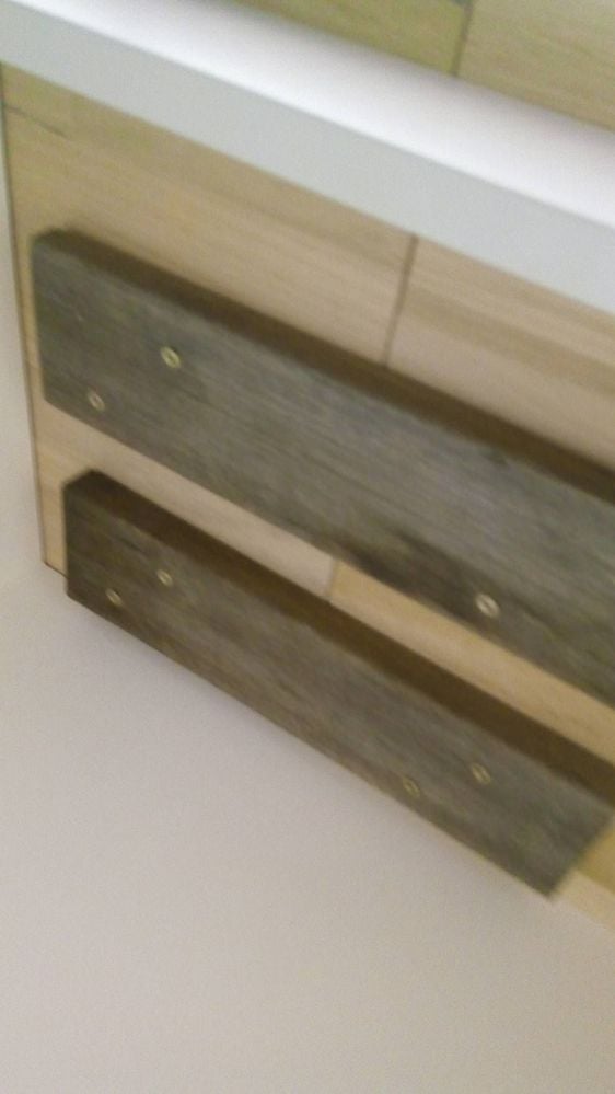

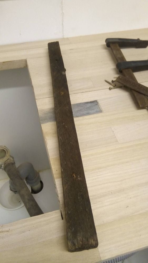

Trying to figure out how to make the thin side of the timber next to the sink strong after cutting it close. (due to the size of the sink)
Strengthening strips...
The small edge being strengthened. One thing I didn't allow for was the spacing for the edge clamps of the sink. They just fitted otherwise I would have been in trouble.

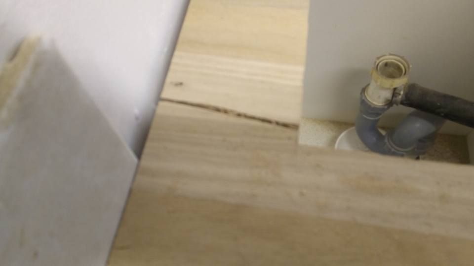

I used the middle part of the sink I cut out for the end of the bench. This was filling was for a cut on the timber when I had measured it wrong.

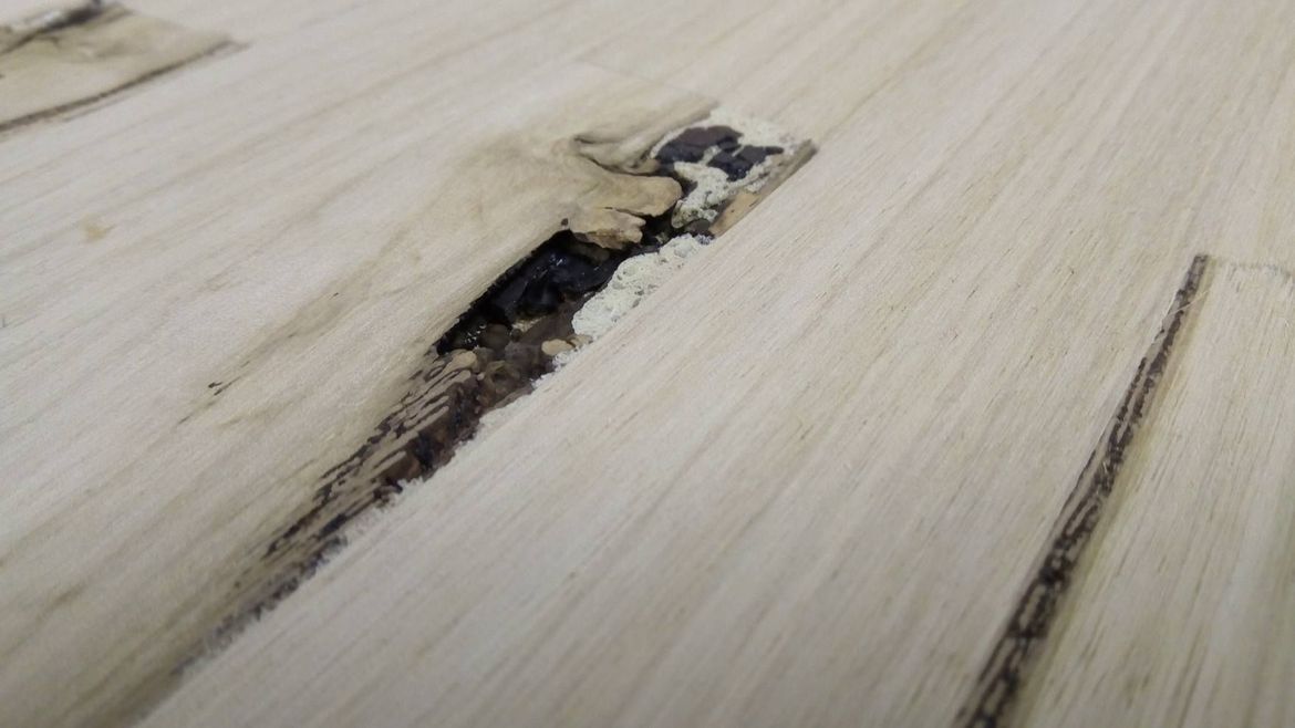

The timber bench top I had bought from Bunnings discounted as it had some rough spots like these. I didn't mind as that was what I was after for this retrofit of the laundry. Reuse as much as I could.

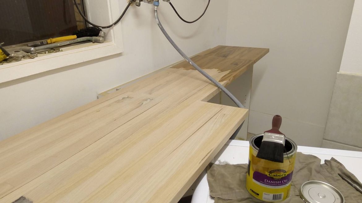

Starting to oil the bench, I didn't want a lacquer as it degrades over time I figured.
The timber really shone through with the oil applied.
The cut that was fixed with timber putty.

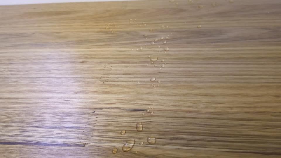

Three coats in and water beads nicely. It still beads 5 years later.
The join is from the piece that was cut out for the sink and then reused to extend the benchtop. Its smooth to the touch tho the grain didn't match. I was happy with it 🙂

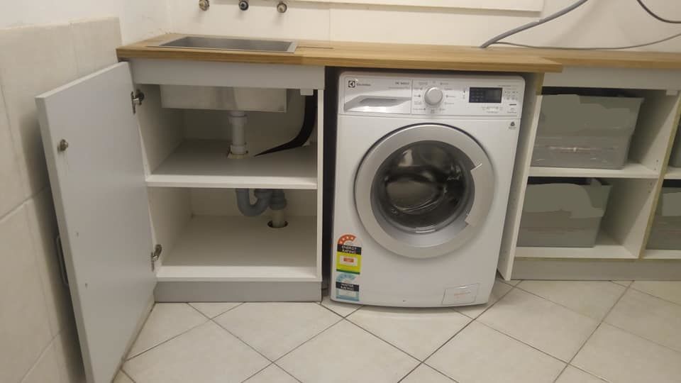

Without the door and shelving added
Marrying up the existing plumbing and the new stuff. Back to Bunnings to buy adaptors. I hadn't thought it through before hand.
All connected and working. Had a little leak at first from a perished rubber O ring but replaced it and no more drips.

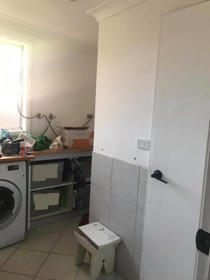

Last stage was tidying it all up and putting back the shelving and storage of tools ect. This was a long job over 3/4's of a year as outside projects were taking priority. Still to do is the splashback of which I do have the tiles but have never actually tiled as nerves is what is stopping me lol
Door fitted, Shelves fitted and buckets "de-loggoed"
I am really happy how it came together. I should "smooth" the sharp corner near the washing machine but thats all I would change.

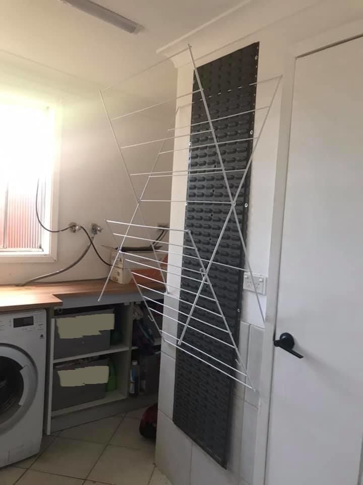

I had wanted to do an "air dryer" for years. This is the spot I had in mind. It would cost $$$ in electricity to run a normal air dryer for clothes, this way it will cost only a fraction of that. I bought a floor fan just for the job and it sits on the bench to the right of the washing machine.
Reused a Storage rack system that was being thrown out at work. I didn't fasten it to the wall at the base as did not want to drill through the tiles on the wall. But did fasten it in six places further up.
Just a normal clothes hanger. It sits in the channels nicely and can be expanded out or shrunk if necessary
Flatter to give more space. It really works well with a bench fan sitting next to the window.Three hours of the fan and the clothes are almost dry.

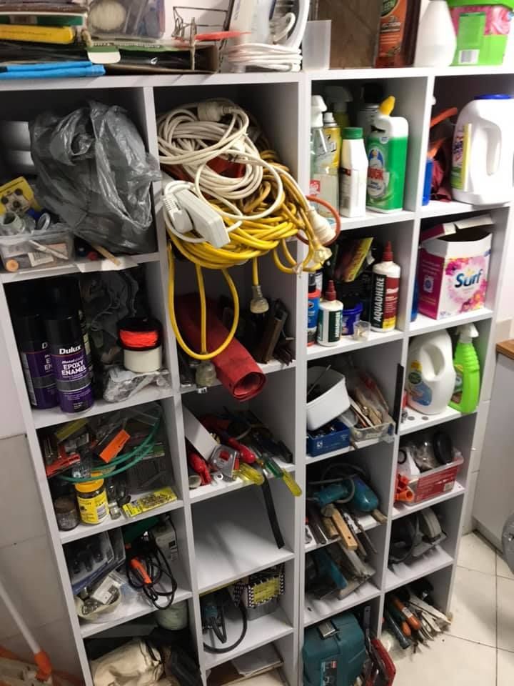

Yep more recycled hutches.These were slated to go to the tip. Fairly heavy and very solid. One thing with tiled floors, don't drop heavy tools on them. I need to get myself a rubber mat. Also they have become stuffed with 5 years of little used items so its about time to clean the shelves.
It was a long project and was glad when I finished it (except for the tiling) The laundry is a very functional room now. Its my tool and laundry storage plus drying room.
