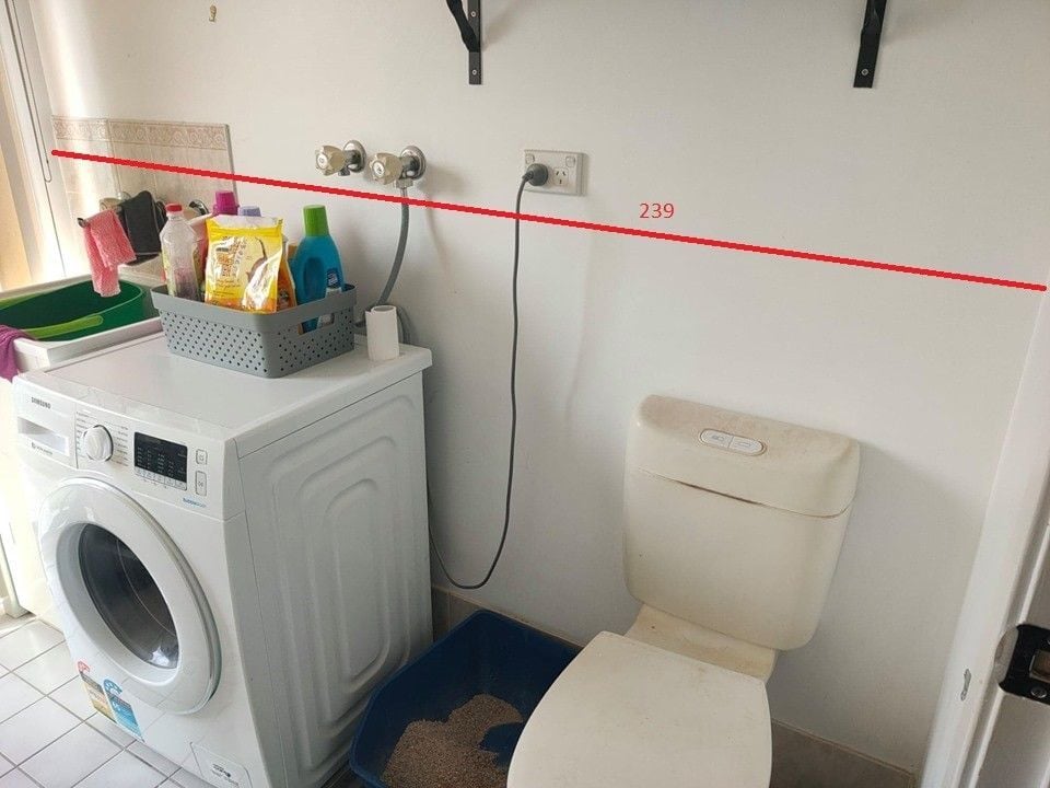

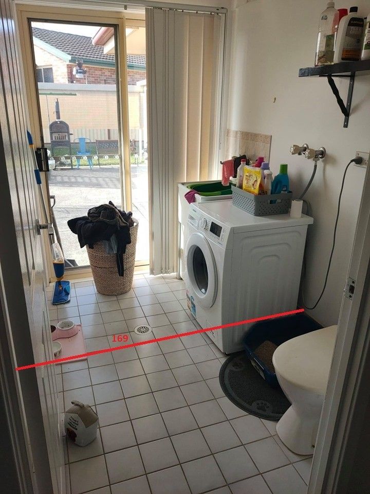

Hi All,
Just looking for opinions/ideas for our Laundry on a budget. As this laundry also has a spare toilet (currently unused until we get the new toilet installed - we already have the toilet in storage and a plumber mate who can install it) we'd also like to make it suitable for a guest bathroom but still functional for laundry/space for our Kitty's litter tray/food etc
We were thinking of a bench the entire length, including over the toilet that would perhaps be on hinges where the toilet sits so it could be lifted when the toilet would be in use but definitely open to all other ideas.
Not sure if we will re-tile the floor at this stage but definitely like the look of large light greyish tiles to about halfway up the wall.

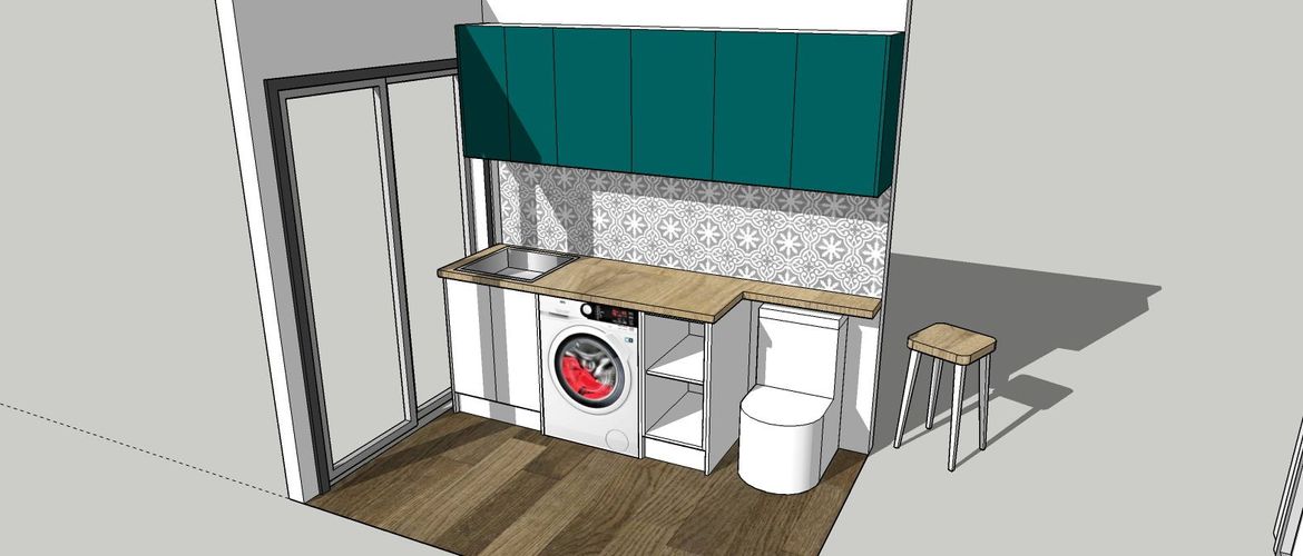

You've got a great space to work with there and what you've outlined is very achievable. I've placed your laundry space into the Kaboodle 3D planner and had a look at what could be achieved with some cabinetry. I think a key element that would need to be swapped out is the laundry tub. Changing the tub to a Euro-style in bench sink will certainly give the area more of a bathroom feel yet making sure it still functions as a laundry.
I would be fond of swapping out those vertical blinds for some plantation shutters on a track system either in white or raw timber as I think that would complement the look.

Wow that looks absolutely beautiful!! Thank you! the only thing I’d probably change is I’d get rid of the cupboard on the right hand side (As much as I’d love to have a hidden washing basket in there!) and just keep a bench there so I can store kitty’s litter tray underneath so it’s out of the way. Absolutely love it!
Totally agree about the verticals also, they’re gone ASAP 😂

You could always install a cat flap on the front of the door, so it's an enclosed litter tray in the cabinet. Just depends on whether your cat would appreciate that or not. It's totally up to you, my render is just something to get you started.
The team instore are much more talented than me in using the planner, so it would be worth getting their expert advice on the layout. Apart from that though if you take a copy of my render and your measurements and adjustments they'll be able to sort it out for you.
For your reference, I've used 900mm wall cabs, a 600mm cab for the sink and the one on the right was a 450mm.
You'll need a plumber to relocate those taps on the wall down below the benchtop or use @Fishvince's technique of running the hoses through it.

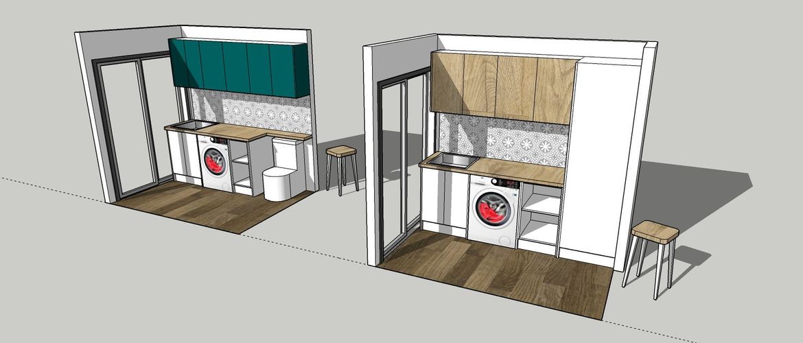

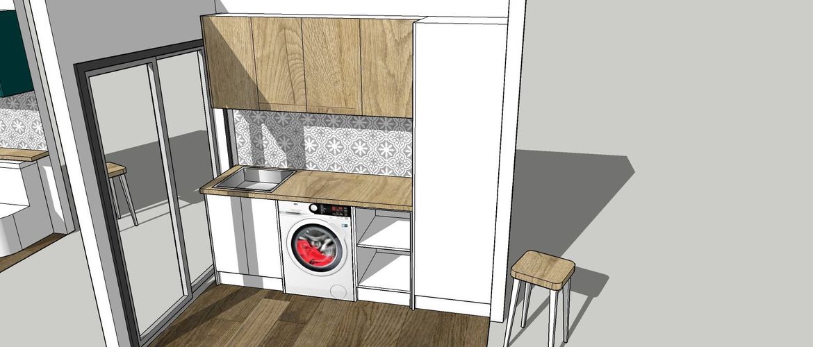

Below are some possible configurations but I believe @MitchellMc has given you an excellent layout. I've drawn a secondary layout just in case you decide to get rid of the other toilet in the future. Good luck and be safe.

Ok so we popped down to Bunnings today to see what we could suss out and essentially we are looking at pretty much the exact design you gave us @MitchellMc !
we are probably looking to go a larger sink however (rococo single bowl square looks the goods) but wondered if Bunnings can cut to size and also cut the right hole for the sink/work out correct placement etc?

We don't want to change the plumbing or wall points so what we would like is the following if possible
You'll have to bare with me with this.
We have enough room for a bench top of 170cm. Any longer and it will be in the way of the toilet we will be installing.
Under the 170cm bench space this is want to fit in this order
x1 floor cupboard which will house a large sink (450x450x200)
our washing machine at 60cm wide 55 long & 85cm high
Linen Chute
For the wall we have an area of 210cm
We would like Wall Cupboard > floating shelf > Wall cupboard.
Floating shelf length will be dependent on available room
Can you please advise what products (with product codes) fit for this layout and if possible have a photo so we can check how it looks.
