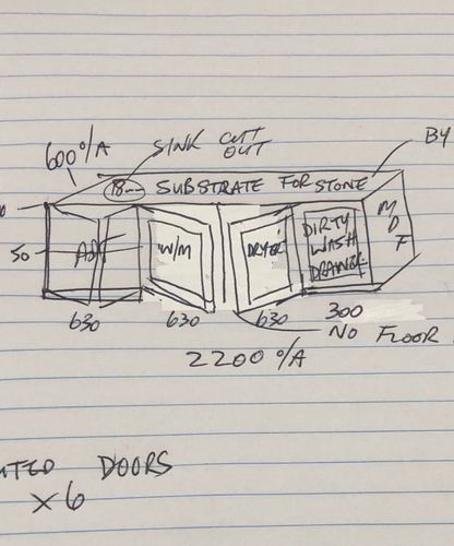

Hello am looking to install laundry cabinets similar to the below design to hide laundry appliances. Would like to achieve cabinets in white / mint green, already have a stone benchtop to place on top. Does bunnings have flat pack options?

The Kaboodle base cabinet systems have a standard depth of 580mm with the doors on. Without the doors, the cabinets are 560mm deep. You can use a Kaboodle 35L Base Mount Laundry Hamper in each of the 450 cabinets. The cabinet widths will fit your current measurements. Notice that I've included pantry end panels and a base end panel in your lineup. You will have to take this into consideration as they are not included in your plan. Each panel is 18mm thick.
I was not sure if you wanted wall cabinets so I have left them off your current sketch. However, if you wish to see them with the wall cabinets, please let me know. Have a look at the drawing and tell me what you think.

Hi Eric,
That looks great everything is perfect aside from: I wanted to hide the appliances and have a door to cover the washing machine and dryer. Its located in an open space and not in a contained laundry room.

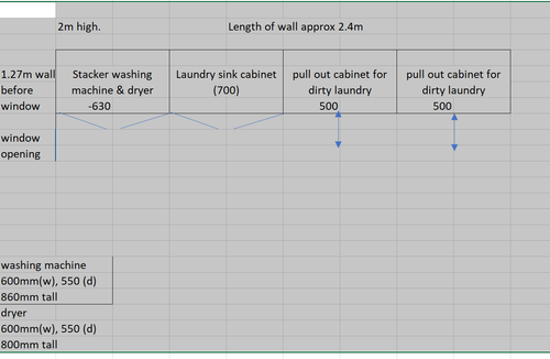

It’s difficult getting a cabinet maker. Was wondering if you could provide an easier installation with kaboodle for something similar to the below. I’m happy to eliminate sink now and just have cabinets, laundry and dryer all hidden behind doors.

HI @cvasin
I've re-drawn your layout based on your new sketch. Please note the following.
Here is the cabinet list.
Please remember that the sizes indicated are for reference only, please adjust the distances according to your needs. Have look at the drawings and if you have any questions, please let me know.
