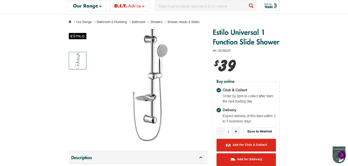

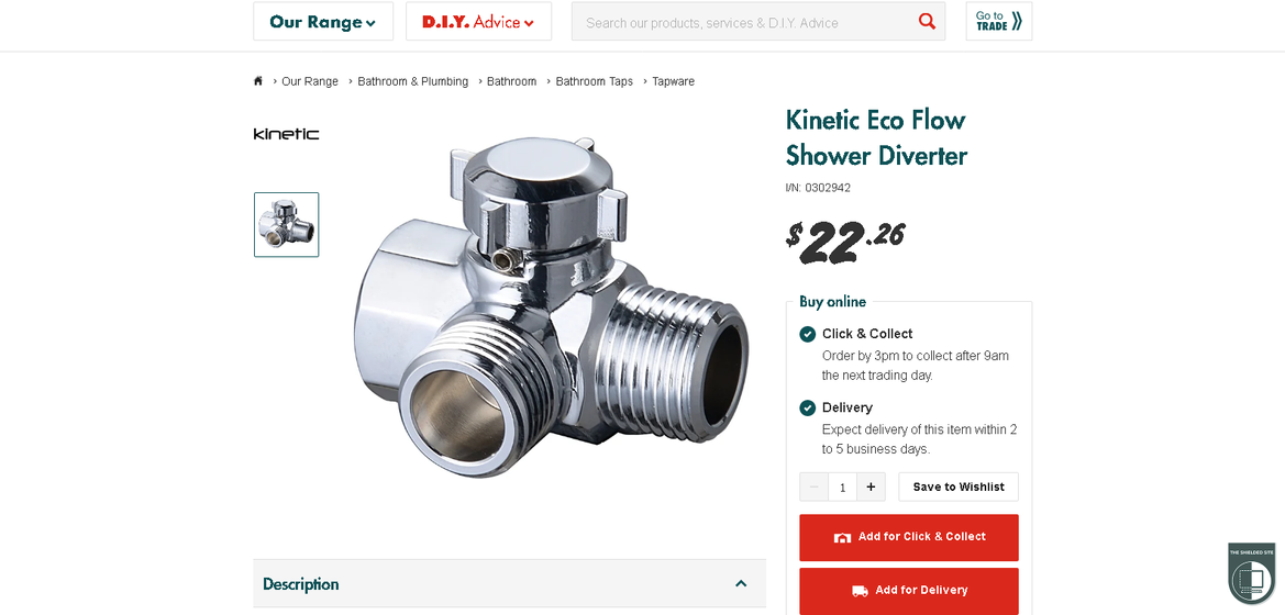

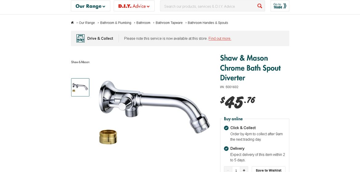

I've lived in NZ and totally sympathize with your current low pressure situation. My recommendation is to get a Shaw and mason spout with manual diverter. But I am not sure if you can get it there in NZ. Your only other option is to modify your bath spout with a diverter and link your shower hose to the spout. As it is a mechanical diversion your current water pressure will stay the same. I've put some pictures below to give you and idea. Good luck and stay safe.

Yes we cannot get that Shaw & Mason here in NZ.
