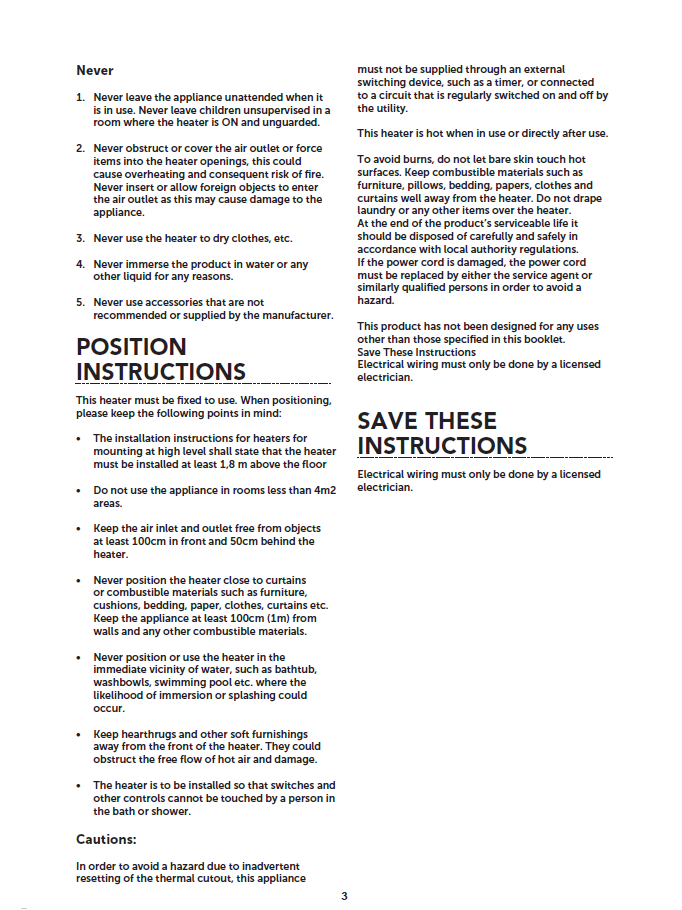

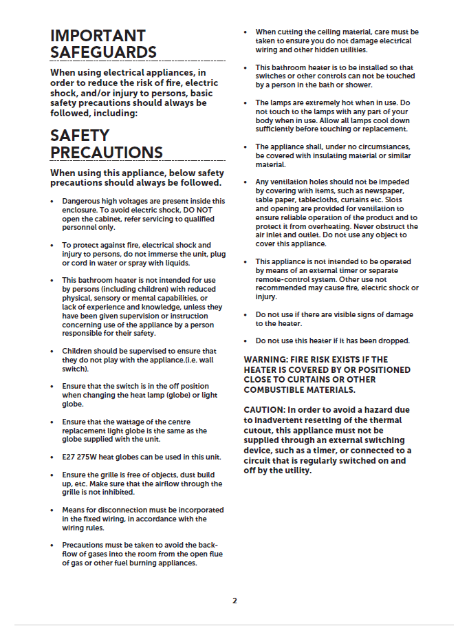

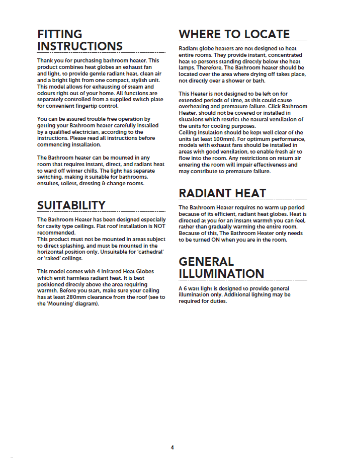

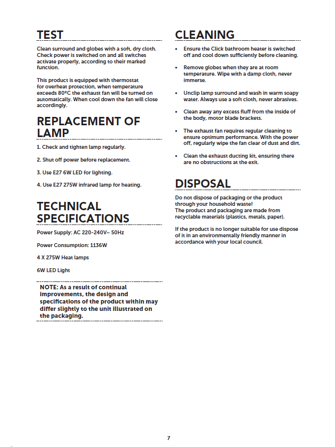

Hi @andrewlyons,
I've emailed those instructions through to you and also included them below. The cutout is 320 x 320mm.
