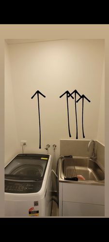

This is my super tiny laundry room with just a washer and no dryer.
Bought a stainless steel cloth hanging rack.  Could only find 1 stud along this wall, concern that I will nail into pipes or wires, what size nail should I use?

Thanks for your reply. I used a Ryobi stud finder over the laundry room wall several times and found that the position of the studs are very different from your picture. Not sure if my builder has done a shonky job, it is a fairly new house. Just concern that I would hit a pipe if I were to nail directly to the plasterboard. Are these studs position normal? (Attached the picture, the arrows are where I found studs).

I suspect that the three lines near the tub are the copper pipes to your laundry tub that the stud finder detected. I propose scanning the wall again to confirm the stud positions.
Here is  a handy step-by-step guide: How to use a stud finder

I have went over this wall so many times and it kept showing up the same results. Why would the stud finder flash green when it detects copper pipes? Shouldn't it be red.
