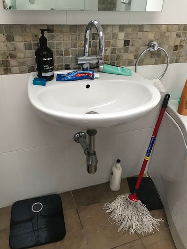

Hi! Good day! I want to replace my basin which is 590mm, I want buy a new basin ,new vanity and all new accessories. The number of basin and vanity in bunnings I like is 0104362. Is it suitable for my bathroom(image 1).? Also I don’t know which accessories I need buy. Thank you all.

That vanity is part of our Mix & Match selection giving you the freedom to mix and match size, format, style, mount, finish, colour, basin and benchtop style. Here is the product brochure where you can select the base and what type of sink you would like to order.
You'll need to make sure that the 600mm wide vanity would fit in the available space. The towel rail might need to be moved as the new vanity could obstruct it. Apart from that, it looks like it would be suitable for your bathroom.

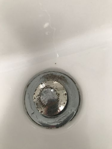

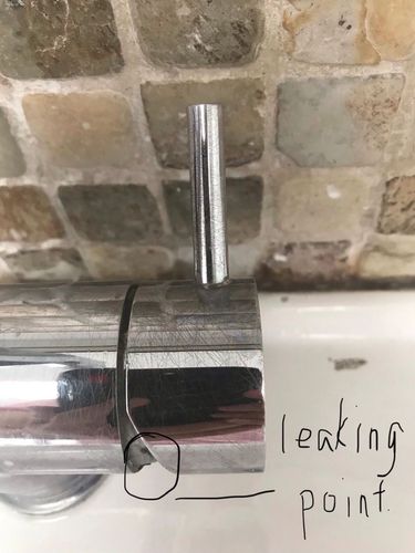

@MitchellMc ,Good morning! My existing leaking unit need to replace . (Image1)Would you mind to recommend one ? I have looked through in bunnings websites,but I am not sure which is better. The existing faucet is leaking bit . A bit water drops from the aperture (image2).All fittings are over 10 years. I want to replace all .

The tapware and leaking unit will need to suit your new vanity. Are you wanting to replace these now and then possibly replace them again when you get the new vanity?
Most of our sink mixers would be a suitable alternative to your leaking tap. For a temporary solution, you could use a budget-friendly option like the Estilo WELS 4 Star 7.5L/min 35mm Chrome Sink Mixer.

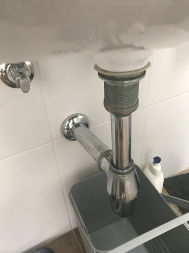

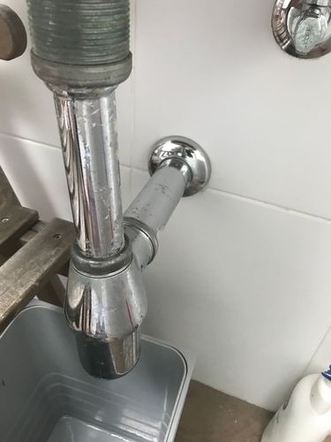

For the drain waste/trap, you would need to show us where it is leaking from and replace the washers. Once again the trap system would likely need to be replaced for the new vanity.
There will be a washer inside at the point where it is leaking. Since it is leaking here it also suggests to me there is a blockage as the water should be flowing freely away and not leaking out here. If you undo the nut which is attached to the threaded section of pipe it will reveal the washer. It will most likely be similar to these trap washers. If you take the washer into a store a team member will be able to match it up for you.
It would be worth un-screwing the bottom section to see if it is blocked with hair etc.
@MitchellMc Thanks! Recently I asked workers to pave yard , and some sands may drop into drain after washing ,I guess.
I will be very appreciate if you can guide me how to undo, how to unscrew, just use a spanner ?
