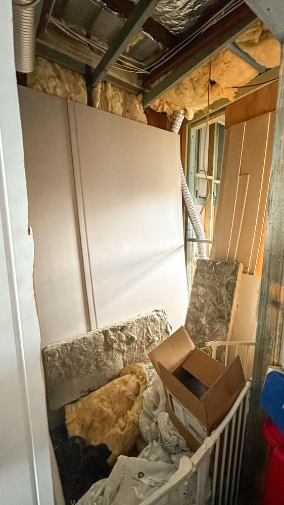

1. Framed up the space
Once we had a new location we framed in the new powder room, insulated and sheeted he wall.

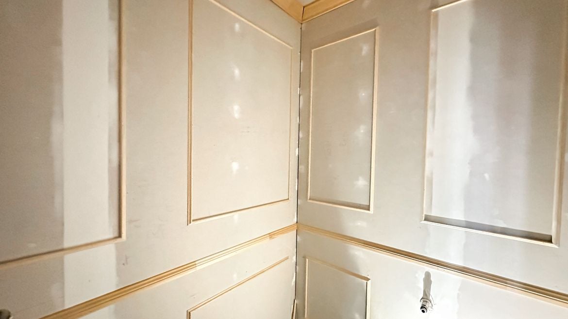

Once drywall was hung it was time to finish these walls and get them paint ready. That meant filling each of the screw holes and taping each of the plaster board joints. I used plaster tape and ran it down the joints on the ceiling and walls where needed. I definitely believe plastering is an artform, one I have not mastered - But A for effort 😂.
I apply the plaster along the line to fill to the grooves then run a wider trowel down to even it out. You want to mix the plaster a little in your container to warm it up so it goes on smoothly. You will often get air bubbles. I left it over night to dry then sanded the next day, I used an orbital Sander to smooth out the joints and the screw holes. I always have to apply a second coat of plaster, much lighter to smooth out the imperfections. Leave it once again for 24 hours or until dry then sanding once more.
You want to run your hand over the wall to feel for an grooves or rought spots, even though they may not be obvious now, they will be once you start painting. So you may need to sand a little more or apply more plaster.

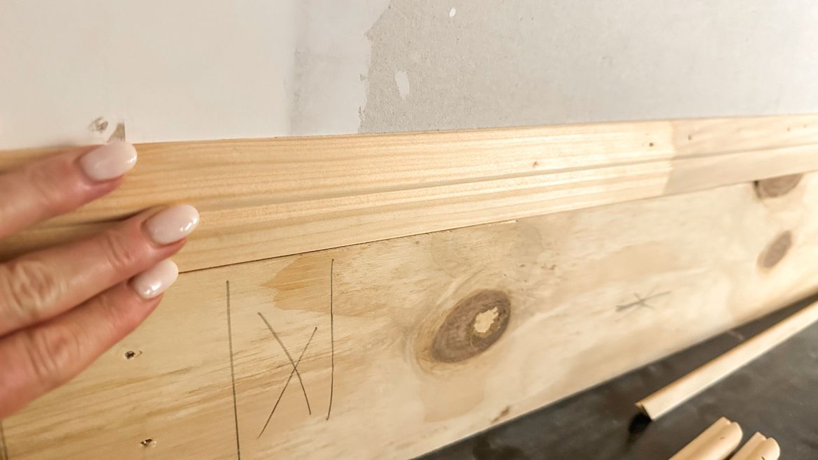

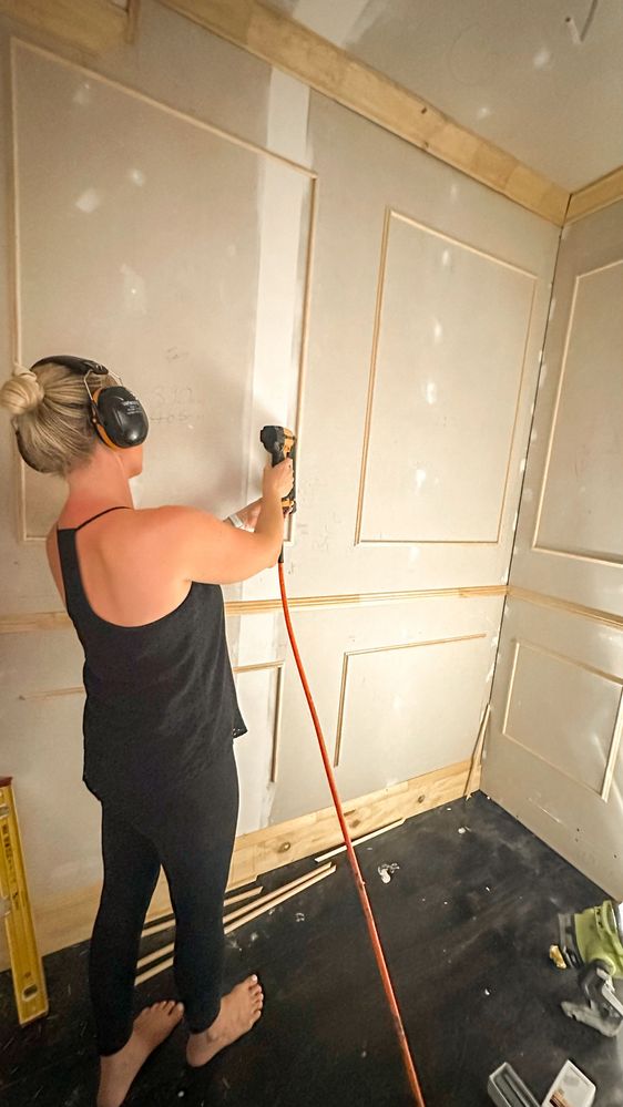

We designed the paneling around the bathroom mirror as it has to be centre of the sink and center of the paneling box. This gave us our starting measurement. I had originally planned for double box paneling but due to the size of the room and the mirror, once it was marked out on the walls we realised single paneling would be better.
We found all of the trim we needed at Bunnings. To save a little money on the skirting boards cut down plywood that we had left over and added a small decorative trim to the top. This made the board look more custom and helped it tie in nicely with the style of the boxes.

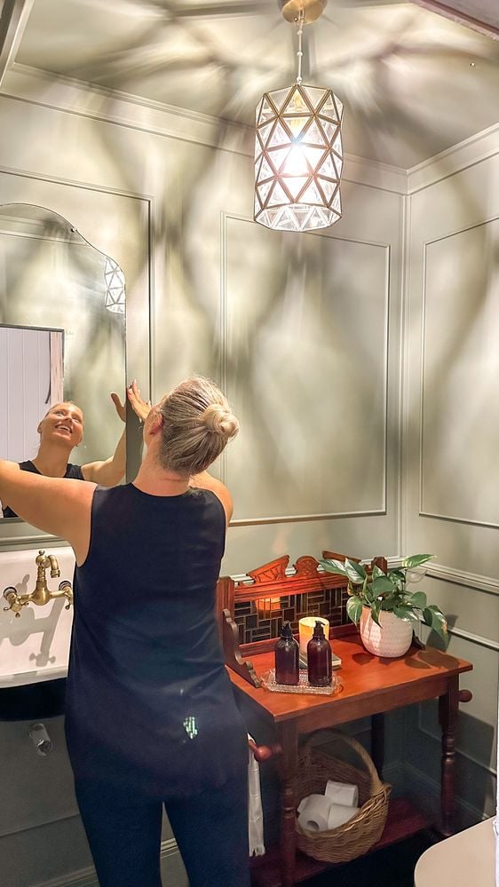

I love upcycling and creating a custom look on a budget. I found this great vintage mirror, circa 1950's on marketplace. It was originally on a dressing table, we removed it from the backing and mounted it directly to the wall using the original bracket.
We used a scew in 2 of the brackets which screwed directly into the timber stud. We used hollow wall anchors to mount the remaining 2 brackets.

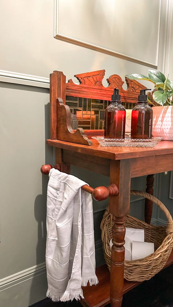

I found this washstand, circa 1920's, in one of our local thrift stores and it was absolutely perfect for the space. I added a thrifted basket and some decor to finish the space.
