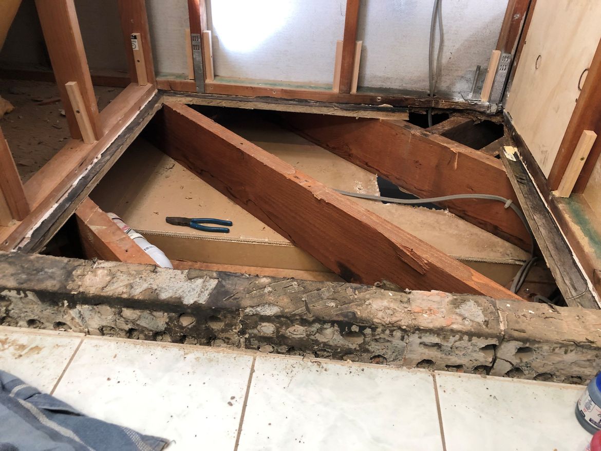

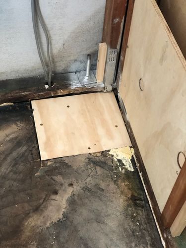

Photo number one is of the floor after rotted timber was removed and replaced. (the shower base was first put down 30 years ago and during that time another layer of tiles was added, possibly to try and seal the leaking shower.. The larger size ply on the right of the photo is to cover the back of a power point so as to protect the plumber. The remaining walls will also have infill added and then cement sheet over the top of that.
The next stage is to measure the size of the area in order to organise a custom base (That will be explored soon) The floor level can be raised then according to the base thickness and requirements for sealing

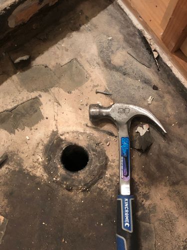

The photos also show the old water sealing (black layer) which is almost impossible to remove.
The 2nd photo shows a further problem and that is the size of the drain. It is about 44 mm wide which may be the result of having had a pipe introduced into the original pipe during a previous renovation. That problem will have to be explored and rectified.

Although there might not be any specific regulations regarding electrical wiring in the wall cavity next to a shower, I'd consider checking with an electrician to see how they feel about having that power point backing onto the shower. As you've experienced, showers can leak, and it's not a great practice to have power points that close to a potential water source. Perhaps an electrician could relocate it for you?
