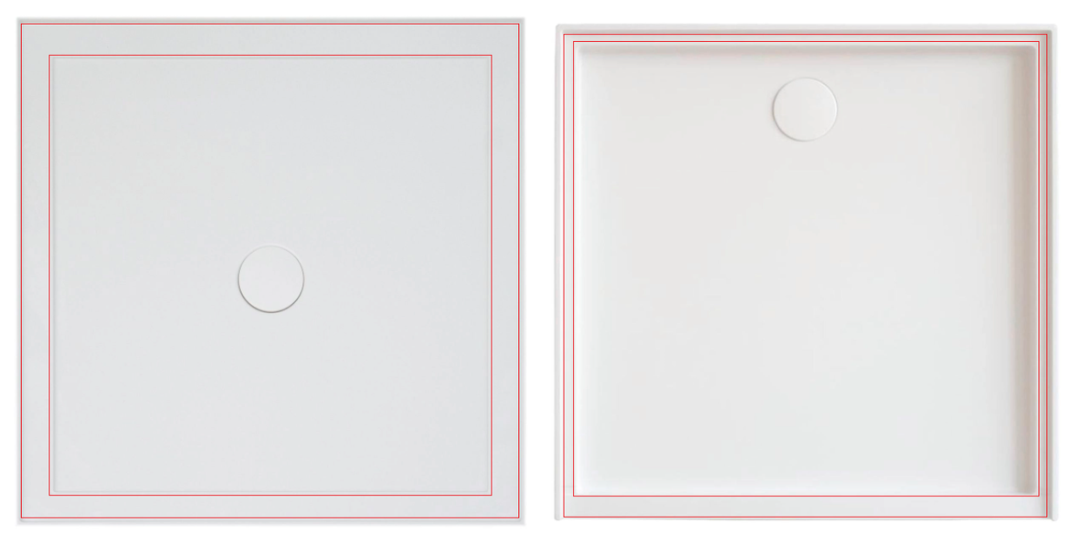

The shower frame is adjustable between 830-920mm wide x 855-880mm deep to suit most bases around a 900 x 900mm overall size. The most popular combination is with the Mondella 900 x 900mm White Resonance Square Shower Base. You could pair it up with other bases, but you'll need to ensure that it fits on their flat perimeter surface. I've outlined in red below the area where the screen needs to sit. The screen sits internally, so that is why it can be adjusted to be smaller than the outside dimension of the 900 x 900mm base.

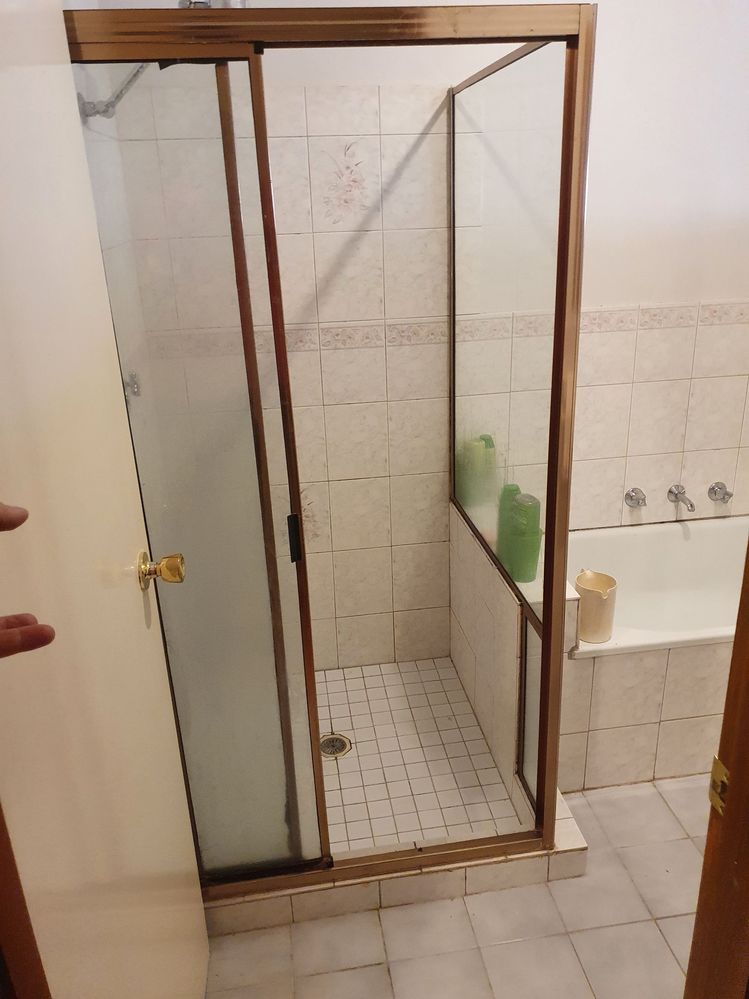

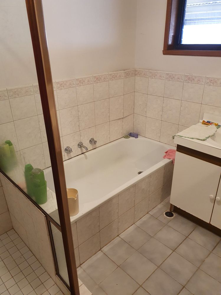

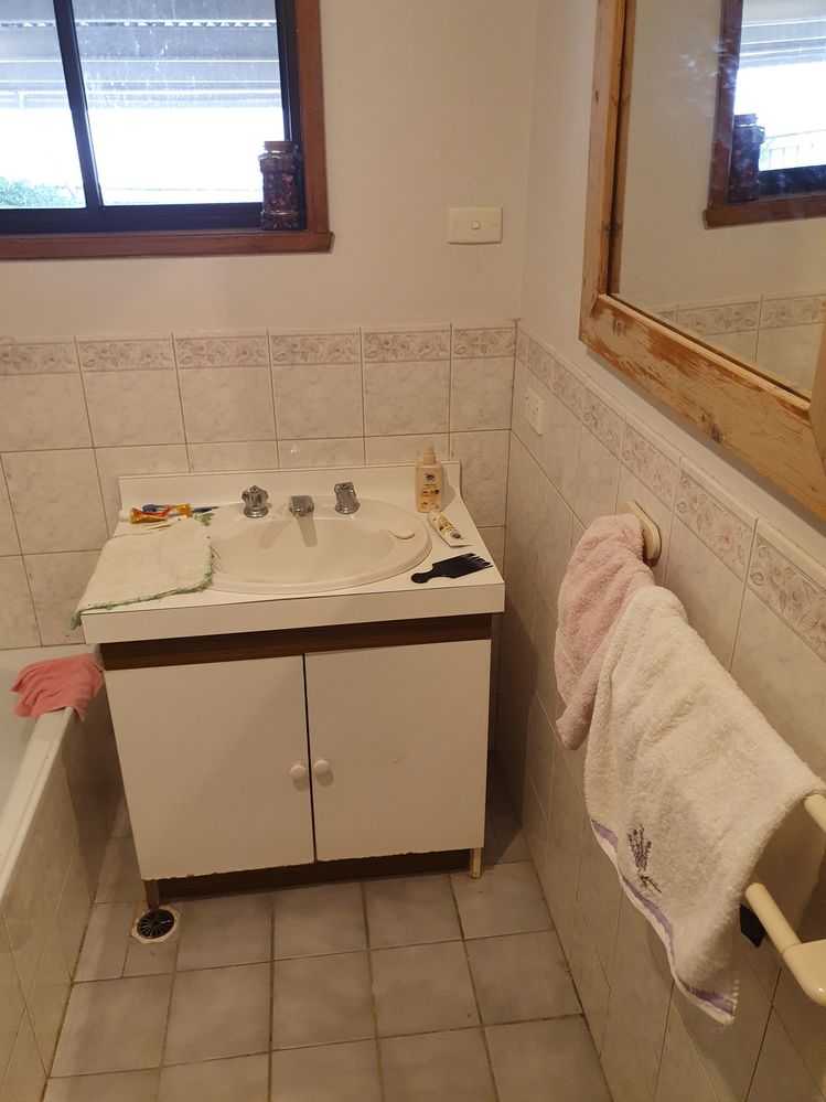

This is the bathroom I'm trying to renovate on a budget.
We have what I initially thought was a reasonable amount to spend (about $10k), but seems that below the going rate that fully project managed bathroom people want to charge according to two quotes I got (Around $17k, even with fairly budget fittings and fixures).
So I'm looking into the option of project managing it myself and sourcing all the bits myself while using licensed trades for most of the main work (like tiling etc) that I'll book individually. Everything to be in the same place it is now, just new of course.
