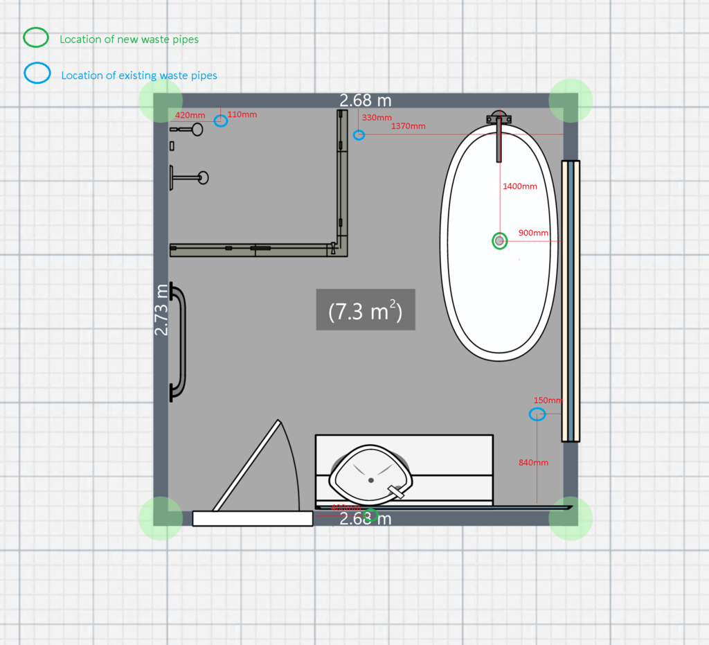

I'm starting to do renovations on my laundry, toilet & 2 bathrooms.
Relocating and shifting the water inlets  is quite simple as I'll be taking down internal walls (re tiling the whole bathroom floor & walls) - thus a plumber can do this once I pull the walls down.
My concern is around the relocation of the waste pipes (40 -50mm) given I am on a concrete slab.
- Shower waste will stay as is
- Bathtub will be relocated (thus waste pipe needs to be moved)
- Vanity will be floating vanity & relocated
 My understanding is I will need to cut the slab to re plumb the waste pipes, however I'm hoping I can cut a linear line from the new waste outlet on an angle of more than 12.5degrees (for fall), into the existing waste pipes (Yes I'll get a plumber to do the actual plumbing work), however I'd like to know whats involved.
Photos below for reference (Green Circles are proposed waste outlets, Blue Circles are existing waste pipes)

I think you are looking into this too much, if you have organised a plumber then best thing to do is wait for him because there will be more than one way of doing this. This photo doesn’t show a lot, but there is no reason why he won’t Chanel a cut from the new to the existing and Just Connect into There, and obviously be concreted back up.
