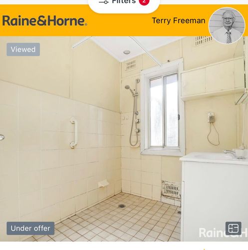

I am starting to do the reno for a 1970’s bathroom . Trying to see how this can be done in budget .
- Need shower glass and new tap head shower fittings
- Tiles I am unsure if ripping off and re tiling is the only only option ( I saw the tile painting option , but this will be a rental
property so unsure if it would stay ? ) . Also not sure if tiling over the tiles is an option either . Any suggestion would be awesome.
- vanity abs cupboards need to go and replaced
- this does not have a toilet . Unsure how much would the plumbing cost if to get a toilet also included . Still thinking
Would be great to hear some budget friendly ideas .
Also this is a fibro redone with brick . So
ripping off the tiles may require the asbestos
specialists to come
in as well . So trying to work around that .

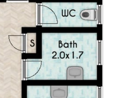

It's great that my colleague @Jason has pointed you to those useful guides to give you ideas. Would it be possible for you to post the dimensions of your bathroom? This will give me a better idea of the space you have and make my recommended sketches accurate. I will post both ideas for you, with and without the toilet to give you a better idea of what it might look like. Please make sure to indicate where the location of the door is.

Thank you for that Eric , does this help ?
Hello @Ron11
Thank you for posting that information. If you are after a quick turnaround and refresh, I suggest regrouting the tiles and repainting the room. Removing and replacing the vanity and mirror cabinet with new ones should make for a quick refresh. Your other option is to tile over the existing tiles to avoid having to spend money on removing the asbestos. If you put a toilet in the current shower room, you will have to engage the services of an asbestos removal specialist.
However, if time permits and a proper renovation is within your budget, I recommend re-tiling the bathroom and putting a toilet in. Due to space limitations, I can only put in a glass panel and not a full shower enclosure. If you decide to not place the toilet in, I suggest removing the glass panel to give you maximum use of the shower space. A shower curtain is an option if you wish to limit the amount of water splashing into the rest of the room.

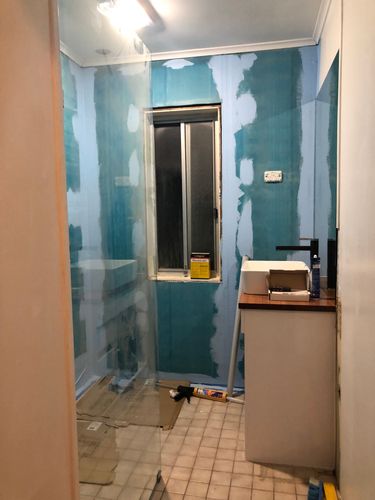

Thanks to all your comments . I am making slow progress with the lockdown . The walls are stripped on on two sides and new cement sheets are put up . Now trying to get the walls tiled . I was told by a toilet that I will have to remove the floor tiles also as you cannot just waterproof the walls . Is that a problem ? Could you please let me know ?
thanks
