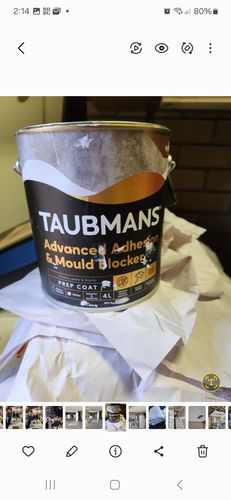

I used Taubmans Advanced Adhesive and Blocker as I wanted to paint bricks as well.

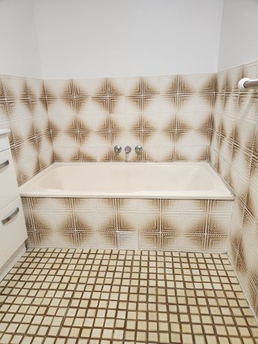

Step 1

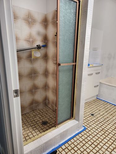

this was the before bathroom

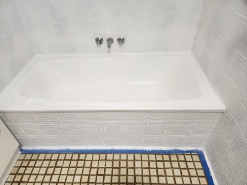

before starting I did do a practice tile with pleasing result before masking up and starting

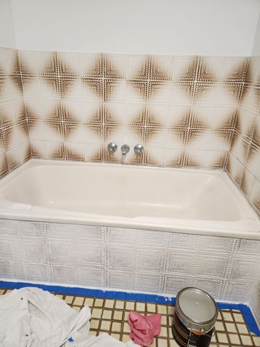

Step 3

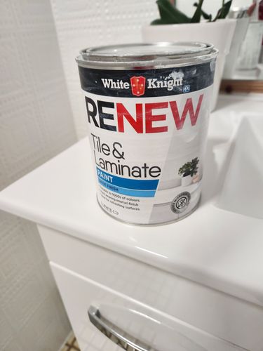

I ended up doing 3 undercoats as the brown of the tiles was very strong. I also had the bath professionally sprayed
Step 4
this was the product I was advised to use from Bunnings Mermaid. I wasn't sure if it would be compatible with the undercoat but apparently both paint companies are under the same umbrella

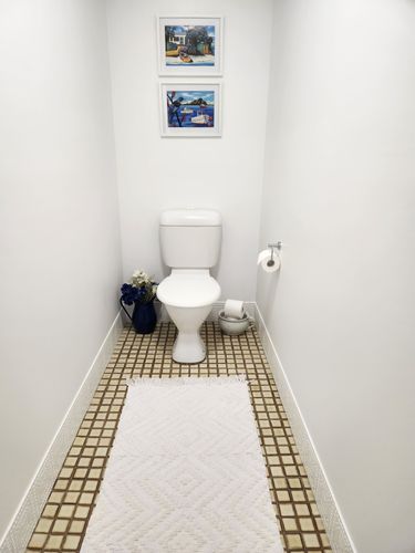

I also did the matching tiles in the toilet, this is the finished result

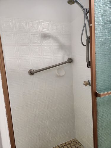

Step 6

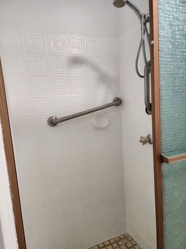

I also got brave and did the shower
Step 7

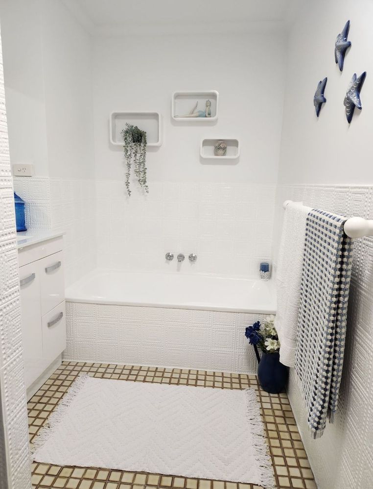

the shower took a lot more masking plus an extra undercoat. I gave the whole space 2 top coats of the White Knight
Step 8

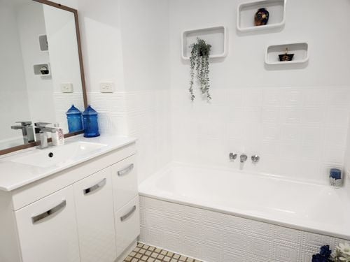

overall I'm very happy with the result
