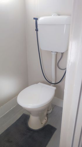

Hi folks, I want to replace my old toilet with a new rimless one and redo the floor with hybrid flooring at the same time. I did some research and most of them advised doing the floor first then toilet. But they do not specifically mention hybrid floor. And I'm not sure if a toilet can be safely secured on top of floating floor boards.
This is the new toilet I'm looking at Mondella back to wall . The old floor used to be tiles, then coated with epoxy. Now I'll be doing a 5.5mm SPC floor on top of that. Should I install the hybrid floor first or should I install the new toilet on the current tile/epoxy floor, then work my way around the toilet for the hybrid flooring? Thank you!

Hi Mitchell,
Thank you very much for your timely response and insight. Can I use silicon caulk/filler to fill the expansion gap instead of trim? I don't think there is a trim that can fit around the toilet (curve line).
Also, I don't know if there's a trim that goes nicely between the white tile wall footing and the new floor (images below).

Hi @novice39,
For our Hybrid flooring, the supplier recommends inserting a filler rod into the gap between the toilet and the flooring. You might need to trim the top of it so it is just below the height of the flooring. You can then use silicone to fill the gap. The backer rod is used to ensure the gap is maintained and the flooring can expand and contract. If you were only to use silicone, this might be too rigid to allow the expansion.
