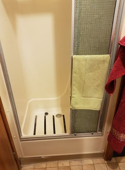

We need to replace a shower bath that is in a relocatable home , the shower bath is too hard for me to step into ,
and would like it changed to a walk in shower in  the cheapest way to do it, .
The shower is in a laundry combined area little hard to take a photo but here is the photo of the shower bath ., we have since removed the glass screens and added a curtain but still need to have a walk in one to make it easier .. measurements are approx 31 x 36 .... hope someone can help as we need someone to do the job as not able to do any manual work at all ..
Thanks so much any help really appreciated or any guide to who we can get to help or do the job.   regards Lorraine Beard.. .

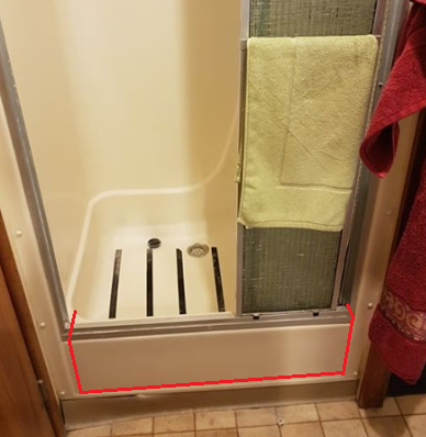

Hi @LorraineB,
I presume that pre-fab shower recess is some type of plastic or perhaps fibreglass depending on the age. I would think there is potential for someone to cut out the front portion and re-fibreglass the entrance. There would be a reasonable amount of work involved but potentially less than a complete fit-out and re-tile. It's a bit hard to tell from the images but the lowest possible point you could reduce the front to would be the height of the inner tray. If that was above the current floor level there might still be a minimal step-up onto the tray. I've included an image below of some suggested cut lines which would then need to be re-sealed and finished with fibreglass.
You might like to consider posting the job on Airtasker to see if there is someone who would be able to take on this fibreglassing job.
Please let me know if you need further assistance or had any questions.
