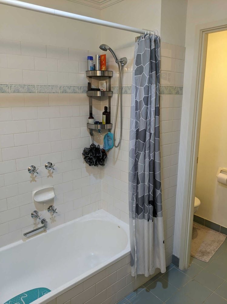

Hi All,
I am planning to do a budget bathroom renovation, and I want to replace existing tiles in the shower/bathtub area. Can I just remove the old tiles and put new ones in the same place? Or will I need to deal with plastering (or whatever) and waterproofing?PXL_20210417_050313645.NIGHT.jpgPXL_20210417_050338057.NIGHT.jpg

Welcome to the Bunnings Workshop community @aleksey. It's fantastic to have you join us, and many thanks for your question.
It really depends on how much damage you do to the plaster whilst removing the tiles. Even tilers make allowances and pre-plan for damaging the plaster. Sometimes, it is impossible to remove the tiles without taking some plaster with it. You will probably damage the waterproofing around your bath whilst removing the tiles, which will need to be re-done. Here's a step-by-step guide which you should find helpful: How to waterproof a bathtub.
Have you considered tiling over or painting your tiles? Obviously, there might not be enough clearance to tile over in some scenarios, but it is an option if you weren't prepared to re-plaster and waterproof.

Hello @aleksey
A warm welcome to Bunnings Workshop! Yes, tiling is involved and removing it causes damage to the plaster board. So take it as a guarantee that any tile you remove from the the plaster beneath it will need to be repaired! I am currently unaware of any technique of removing tiles from plasterboard without damaging the plaster. My best suggestion for your plan of attack is to do it in sections so you are not overwhelmed with the process.

Hello @aleksey
I believe that it is more time saving to replace the large sections rather than repair. You can repair the little parts like skirting but the large sections would be better to be just replaced. Then all you would need to do is plaster repair the joins. Then you may call your waterproofer and save time and the re tiling will go much quicker. Please keep us updated with your progress and if you have anymore questions please post it here workshop.

Hi @aleksey,
It's great to see @redracer01 has been assisting, and I would agree that replacing a section of the plasterboard would be easier than doing many patched repairs.
I'd pause for a minute after removing the floor tiles and assess what the substrate is. Perhaps post some images to get feedback before proceeding. You might have a choice between levelling the area or grinding the adhesive off.
