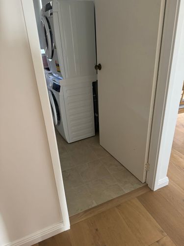

Hi, I am considering re-doing my internal doors and am looking at the option of a bi-fold door in the laundry. The laundry is only a small space (~5m2) so a bi-fold door will give me an extra ~400mm wide space for clothes baskets etc etc. A bi-fold door will be more expensive than a normal hinged door, and seems more tricky to install.
I am also concerned about the bottom pivot being screwed into the floor. The floor transitions about halfway across the jamb from tile to an angled engineer timber threshold (see pic) and I don't want any risk that the tile will break because they are new last year and cost an arm and a leg to have installed.
Hume Doors also recommended that bi-folds are installed in jambs with a stop (as for hinged doors), because the bi-fold might rub against the jamb. A carpenter I was considering for the job said that the existing jamb would be fine. I think if there is a flat jamb there will be gaps in the floors because they are fitted around the stop jamb.
What are people's thoughts on bi-folds? Are they worth the extra cost and effort? Will a bi-fold work in my situation - with the existing jamb and the bottom pivot?

Technically it would be possible to install your bi-fold door in reverse so that it pulls out rather than push in. This means that you'll avoid drilling into your tiles and drill into the engineered floor instead. The transition piece will need to be modified and the spacing triple checked to make sure that the door fits properly.
Having the bi-fold open out will give you maximum usable space in your laundry area. If done properly the bi-fold door should not look out of place.

Thanks @EricL  for your suggestion. Unfortunately i don’t think it would be practical to swing the bi fold out because you would not be able to get past it in the hallway. The hallway is about 850mm wide there.
