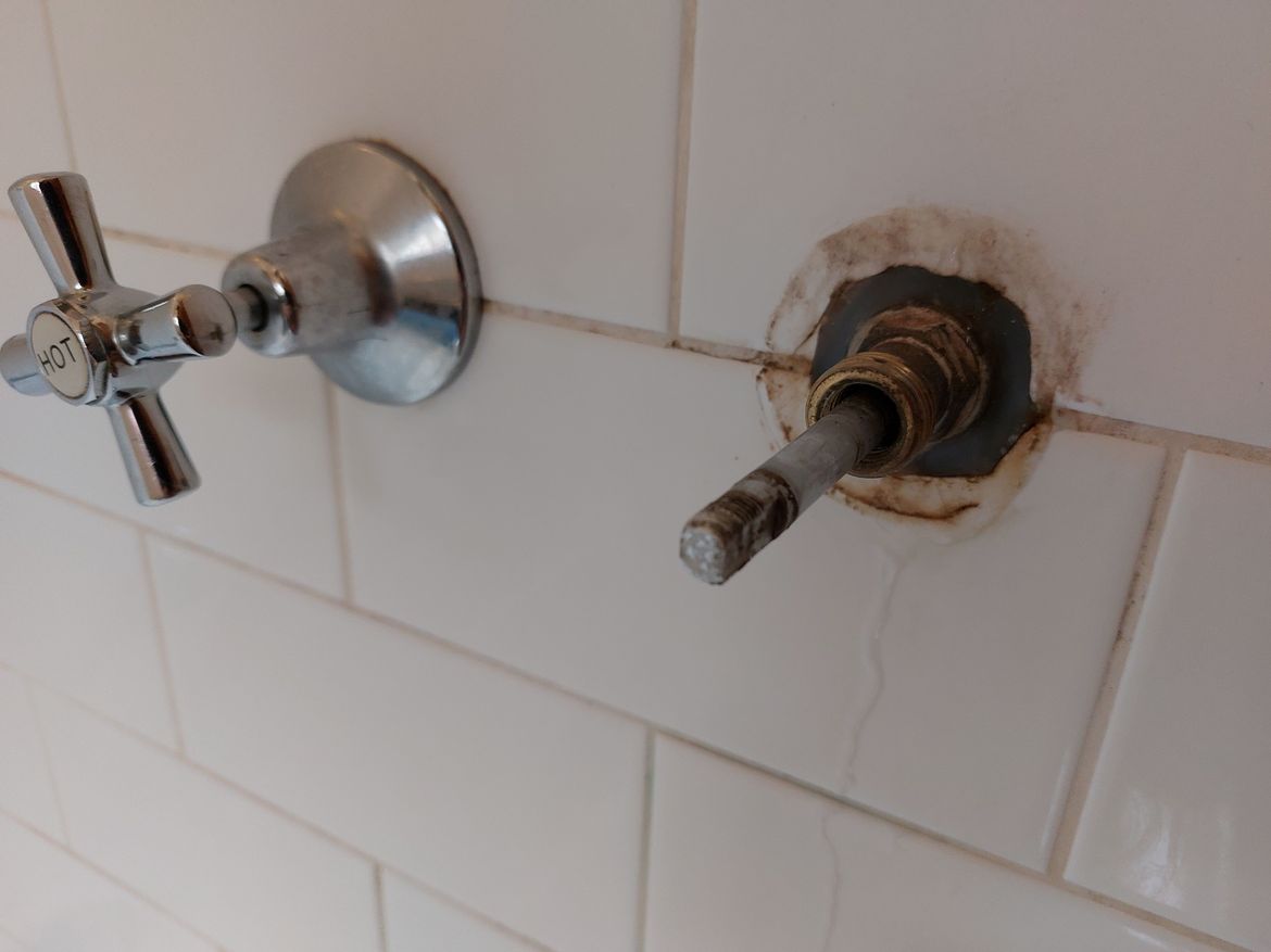

My shower cold water tap is not turning off & I think it may need a new valve. I’ve tighten inside which it hasn’t helped this time around. I’m seeing conflicting information about whether I should attempt to fix it on my own (DIY beginner) & if it’s even legal for me to attempt in Victoria? Do I need a plumber or should I head into Bunnings & give it a crack?

Changing a tap washer is a relatively easy D.I.Y. task, and I trust we can successfully guide you through the process.

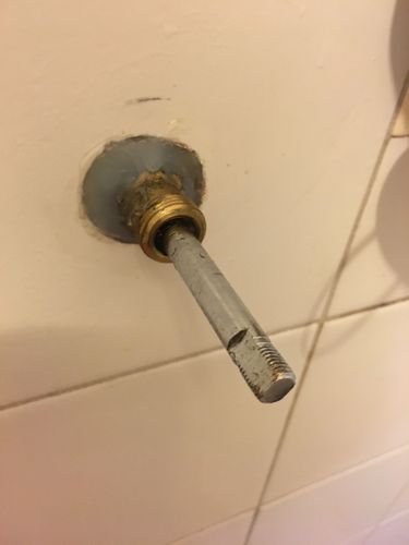

In order to remove the spindle, you'll need to start by cutting or digging out the soft silicone placed around it. Once this is removed, you can use a tap spanner to undo the spindle from the wall. If you are heading down to Bunnings for the tap spanner, pick up a couple of tap washers while you are there. Replace the leaking washer and screw the spindle back in place. Apply Selleys 100g Clear Ezi Press Wet Area Silicone around the spindle to seal out water from entering the wall. Finally, screw the tap flange back down and attach your tap handle.
Regarding your question on legalities, please see the Victorian plumbing regulations 2018. You'll note on page 27 it states the following:
Plumbing work that may be carried out by unlicensed or unregistered persons:
(1) For the purposes of section 221D(2)(b) of the Act, the change over of a water efficient shower head in a dwelling is plumbing work that may be carried out by a person who is not licensed or registered by the Authority.
(2) For the purposes of section 221D(2)(b) of the Act, the repair or replacement of tap washers and other minor tap repairs in a dwelling is plumbing work that may be carried out by a person who is not licensed or registered by the Authority whether or not the person owns or occupies the dwelling.
Please let me know if you run into any difficulties with replacing the washer.
