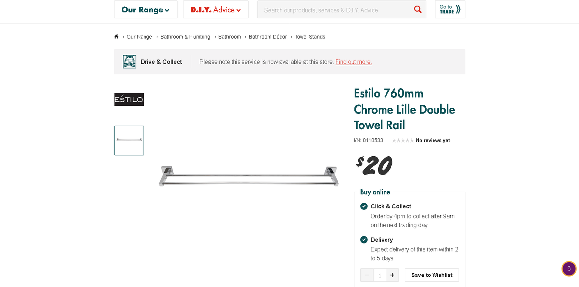

Simply buy this towel rail and pull one of the ends off. The rail can then be cut down to the size you need it to be so that it lines up with your existing fixing points. Use a hack saw or a grinder if you have one and just safely cut the ends off to the right size. Once the rails are cut simply push the end back on and you have a new towel rail at the same old size. There are many more models with the same adjustable ends at Bunnings.

Thanks Red for the quick reply. Sorry I am talking about a vertical
shower riser tail that a shower head connects to inside the shower, the type you can slide the shower head up and down on.
