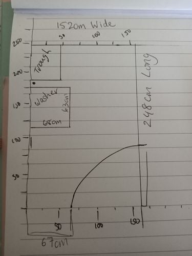

The room size is 248cm long, 152cm wide, trough is 61cm long 47cm wide, there is a 20cm gap between the washer and trough, washer is 63cm long and 67cm wide, when the door opens there is 67cm from wall to door edge. Door opening to end of wall is 158cm.
Black dot on drawing between trough and washer is the waste water pipe for the washing machine.

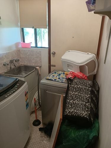

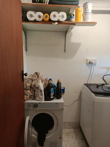

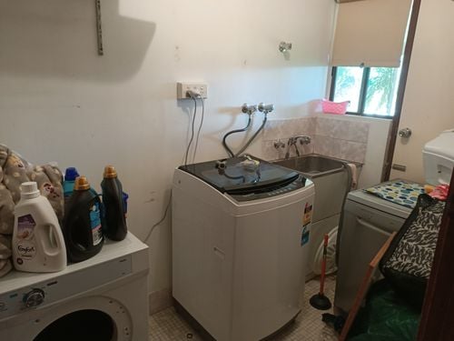

From doorway looking to the back door
From doorway looking straight ahead
Wall with door on it
Please excuse the clutter, the laundry becomes a dumping ground

Thank you Eric, i really like the design layout you have done, I was thinking of removing the door completely, but a sliding door is a great idea, only thing to note is the door is on the longer wall, I'm not a skilled drawer! The bench would be very handy, is this secured via brackets on the wall?

How much space do you have between the washer and the dryer?
Depending on that space, you may be able to push the dryer up against the washer and then put a broom cupboard against the wall in the corner (where the dryer is now). Then put a benchtop over the dryer and put wall cabinets or shelving above dryer, washer and trough to utilise that empty wall space.
That way you can keep the door where is, otherwise if you choose to close off the door you could add more cabinets along that other wall too.
