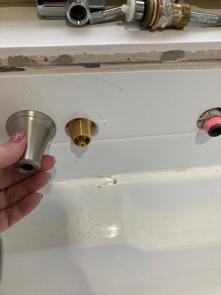

We purchase a 15mm brass extender for our tapware and while the length was fine, we are unable to screw it in as it was to big.  Can you purchase smaller extenders or is there another solution

It looks like you've successfully installed a Kinetic 15mm Wall Tap Spindle Extender and the issue is that the tap flange is not able to screw into it. Is that correct?
If so, can you advise what the internal diameter of the thread in the tap flange is?
It may be possible to use a brass adaptor such as this Brasshards 20 x 15mm Brass Threaded Hex Reducing Bush or Brasshards 15mm Brass Male / Female Threaded Adaptor to either reduce or increase the size of the thread to accommodate.
I am not 100% certain of this fix, so any additional details you could provide would certainly help.
Allow me to tag some of our knowledgeable members to see if they have any other solutions, @Noyade, @Nailbag, @Dave-1.

I havnt had a lot of experience with tap extenders so I think I will watch and learn a bit. It makes sense what you are trying to do. Tho like @JacobZ I am a little unsure if you are asking about the shiny metal bit next to the extender not being able to be attached? Or its the center spindal that isnt able to be attached?

Hi @nicholeh101 It appears that though you have extended the external thread with the extender, the internal tape spindle is well inside. The shortest one available is 15mm.
But failing that you could consider replacing the spindle with a longer deep seated version which might solve the problem. These are available in few different finishes. Though having said that, there may then be an issue with the actual tap handle fitment, which would mean making a change.

There are a few of issues going on here, the first is that your spindle is exceptionally short. Are you using a wall set or basin set? Wall sets have longer spindles which you can then adapt with a spindle extender if needed. The second issue, is the threaded extender you've used appears to be for pipework, not to extend a spindle as per the link I've shared above. The last issue, is that is just about the tallest cover plate I've ever seen. So, hopefully, once you've got yourself longer spindles as per @Nailbag's advice and you've used a spindle extender if needed, that should put you in a much closer realm to getting the coverplate/dome to fit.
