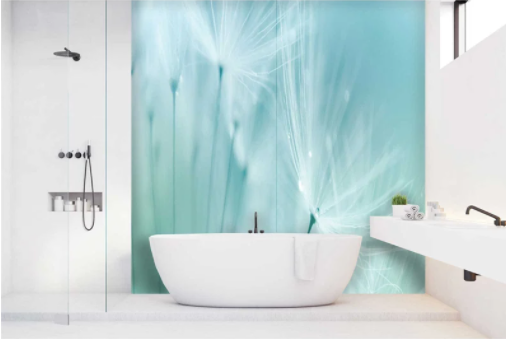

I'd suggest investigating wallpaper that is designed to be used in wet areas. The extensive amount of humidity generated in a bathroom can cause standard wallpapers to peel off the wall. As an alternative to wallpaper, we can order in the full range of Bellissi polymer bathroom panels. You might also like to consider Wall Art wet area panelling or Easycraft wet area lining boards. Due to these panels being thicker than wallpaper, you could avoid removing the bottom tiles.

Big Thanks mate @MitchellMc
Great options. Will share with wife. I'm sure she'll like them.
The one you shared is particularly amazing looking
