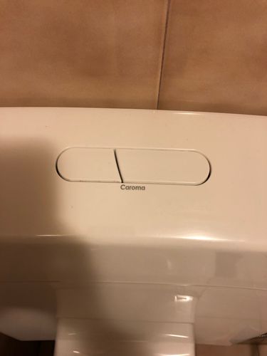

Hi
I am unable to open the lid of the toilet tank.
it’s a plastic tank named “Caroma”.
There are 2 plastic buttons to flush.
Can you please help?
Welcome to the Bunnings Workshop community @rahulyadav5. It's wonderful to have you join us, and many thanks for your question about cistern lid removal.
Work your way around the outside of the cistern, pushing it in just below the join line. By pressing in the cistern sidewall, you will disengage a few clips around the outside. As you do this, lift the lid section. There should be a clip on either side and possibly a couple at the front as well. You could also try slipping a flat head screwdriver up under the lid to disengage the clips.
Please let us know how you go.
Thanks for the quick response!
It solved the problem. I was able to open the lid.
Thanks a lot ![]()
