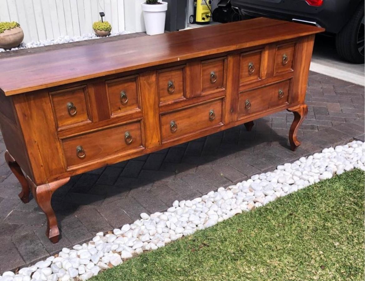

This bathroom will be shared by our 3 kids so I wanted to add a larger vanity, this was proving expensive so I decided to get creative. After searching for some time on marketplace I finally found the piece I was looking for.
It was the size and structure I wanted but aesthetically it wasn’t hitting the mark and I had to figure out what to do with the counter as wood in a bathroom with 3 kids, 5 and under would be disastrous.

Here's what it looked like before

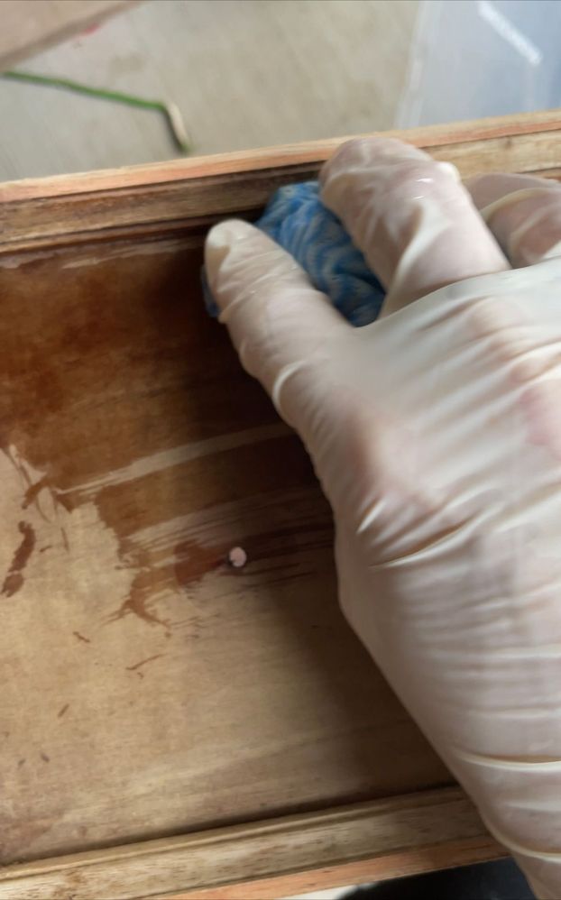

Step Three: Bleach
I poured some household bleach into a container and using a chux cloth I wiped down the cabinet and drawers like you would a stain. Once it’s completely dry you can see the impact of the bleach, to get the look I desired I repeated this step.
TIP: Don’t do the inside of the drawers. I did and couldn’t get a nice even finish so I ended up staining the inside a darker brown.

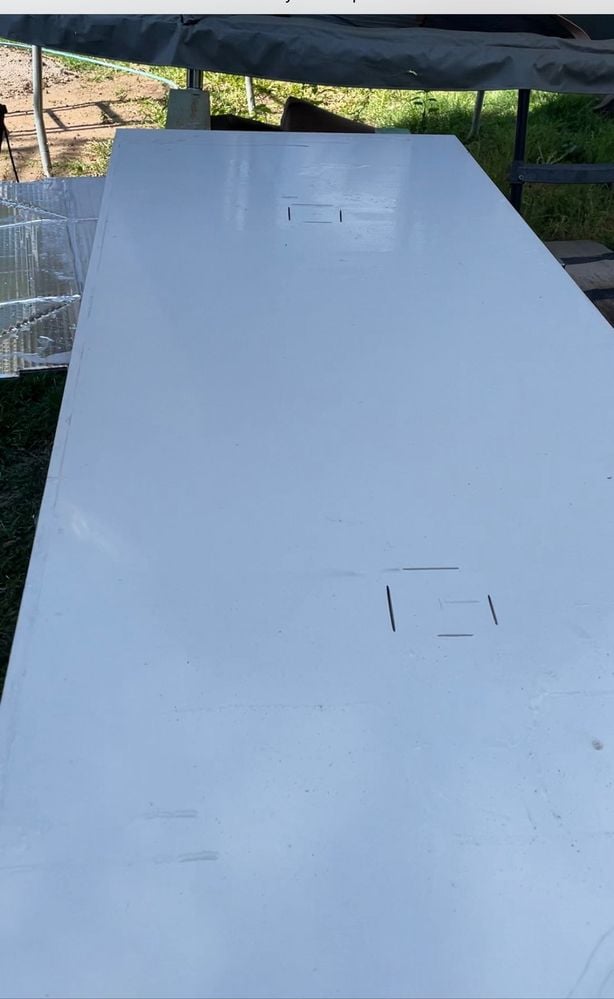

We found an amazing piece of white quartertone (exactly what I was looking for) on the market place. We cut it down using a grinder, keeping it wet during the cut. Then measure out our plumbing holes and made 4 incisions on both sides of the stone, and made the final cut. As this was something we had never done before, we opted for surface-mounted sinks in case we weren’t able to get a neat line, it also meant we didn’t have to build the cabinet up.
We left the stone its original width as we were worried about it cracking, meaning that the counter went from 540 to 620. This worked out wonderfully as the plumbing had been installed from the floor, so it left a void behind the cabinet for the pipes, saving us from losing several drawers. So it wasn’t wasted space, we added some pine at the end of the cabinet by the toilet to create a hidden shelf.

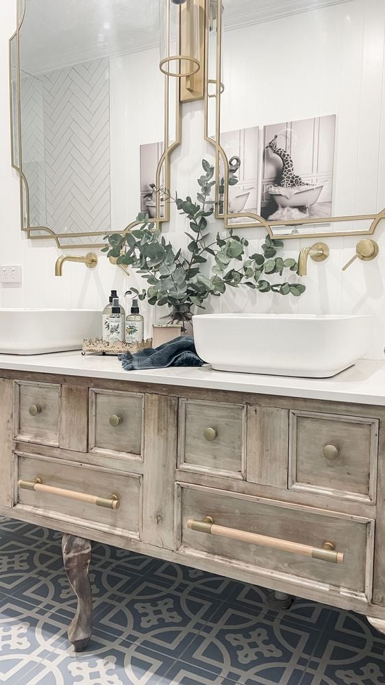

Step Eight: Sinks
We decided to install the sinks longways, this meant they were more practical with the deeper counter and it left more useable space between sinks

Step Nine: Stain the vanity
I love the colour of the vanity but it needed a finishing touch to even out the finish and add a waterproofing finish to the vanity.
I decided to use Liming White by Feast Watson and applied 3 layers, waiting at least 2 hours between coats.

Step Ten: Handles
I didn’t like the handles that came with the cabinet, so decided to replace them.
For the top drawers, I bought some basic black mushroom handles from Bunnings and painted them using Dulux Metalshield primer and Dulux Metalshield Hammered Bronze.
I made the bottom pulls using a piece of dowel and copper plumbing tees. I painted the plumbing tees with Dulux Metalshield primer and Dulux Metalshield Hammered Bronze.
I cut the dowel for the middle bar, the ends and the middle to connect to the cabinet and secured them using hard as nails. I stained the dowel using Feast Watson Liming White applying 3 coats.
