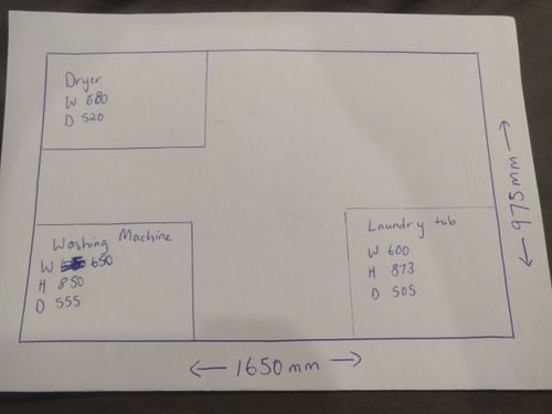

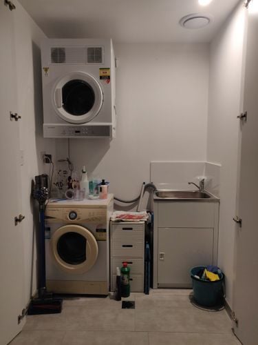

Hi all! We just moved into a 2 bedroom apartment with a very small laundry area (1650x975mm) which has absolutely no storage. We are looking for ways to maximise the small space and it would be ideal for additional storage but understand our options are limited.
We are hoping to keep the existing sink/laundry tub for now and just add a benchtop over the washing machine and if possible, some very narrow storage (anything that may fit) under the benchtop in between the washing machine and laundry tub. Open to any design ideas.

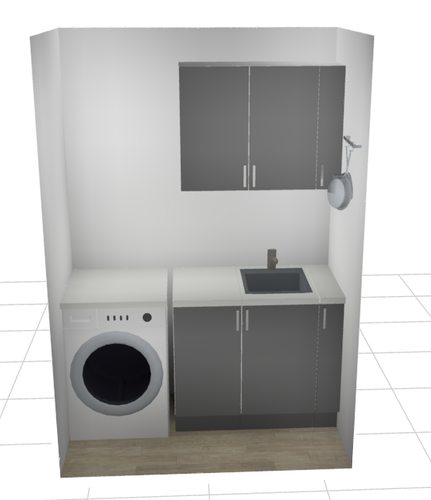

If your budget can stretch to a plumber, removing the old tub and changing to a 450mm sink will be a game changer for storage.  Couple of ideas below - the choice depends on what you want to store and whether you value bench space or cupboard space.
If you don't use the sink much, you could also get an over sink chopping board for extra bench space.
Install the Dyson wall bracket on the left wall, and add a hanging rail for broom and mop on the right wall.  Or you could put in a tall cupboard for Dyson, ironing board and brooms.
(And apologies I use the Kaboodle planner and it doesn't have a separate dryer :smile: )
HTH - Ari
