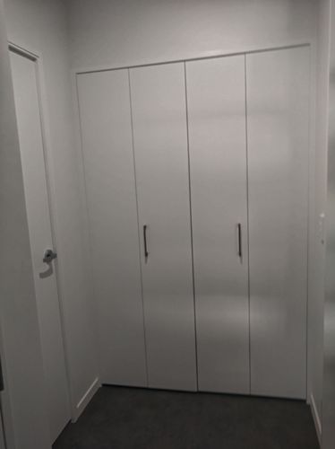

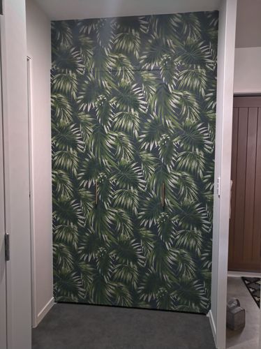

I had this idea since we moved into this house as all our walls and ceilings are white and I wanted a pop of colour. I had never applied wallpaper before this so it took me a while to build up the courage to do it. It was a lot easier than I expected and I love how our laundry cupboard is now camouflaged into the wall.

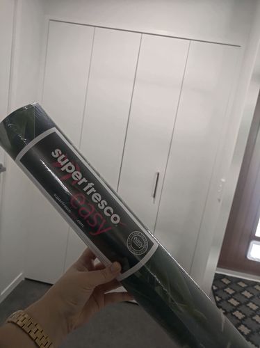

I used sugar soap wipes to clean the walls and doors first, then I mixed up the adhesive from the Wallpaper Application Kit and I chose the Superfresco Easy Elegant Leaves Green Wallpaper which can be removed easily later on if I ever want to change it. I also used a craft knife to cut the wallpaper down to fit each door panel once it was applied so the doors could be opened.
The glue was simple to apply to the doors with the roller in the application kit and the wallpaper pattern was easy to line up by sliding the paper into place once it was semi-stuck to the wall. I still need to get a test-pot of paint colour-matched to the wallpaper so I can touch up the door edges but I'm really happy with how this turned out!

That wallpaper looks excellent and has not only hidden the bifold doors but your laundry area as well. I had to concentrate to see the handles from the background, but if you were to paint the handles the same colour they would be very difficult to spot.
