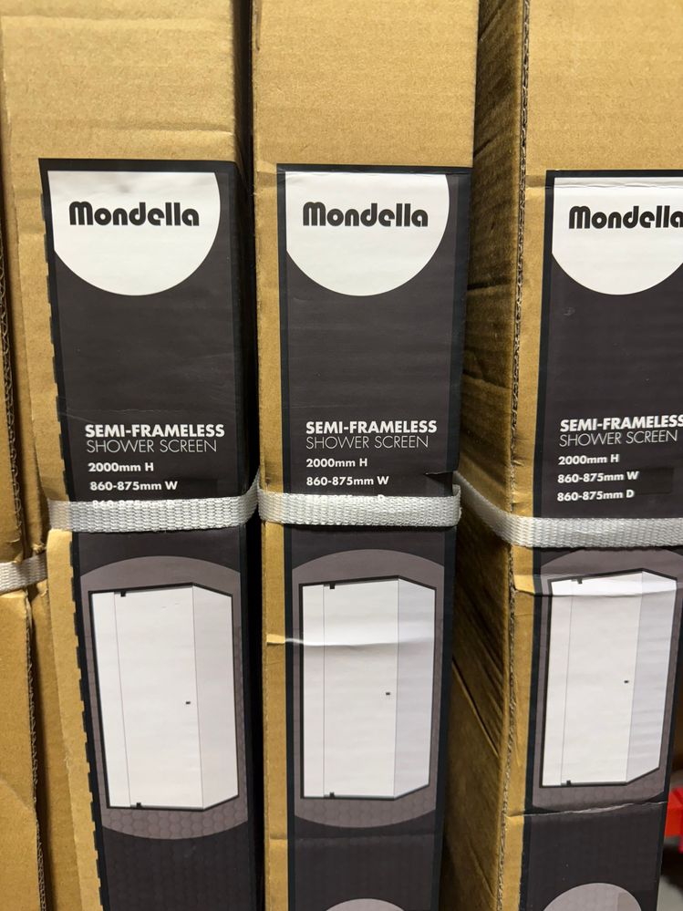

What base for Mondella semi-frameless shower install?
DinnyP
Hi could you please tell me if I can install the Mondella semi framelss shower 2000mmH 860-875mmH 860-875D with the Mondella Resonance SMC 3-lip shower base 900W 900L 35H
Re: Semi frameless shower install
Welcome to the Bunnings Workshop community @DinnyP. It's a pleasure to have you join us, and many thanks for your question about Mondella shower screens.
Yes, that shower screen fits on that base. The base itself is 900 x 900mm, but the screen, at 875mm, sits on the raised inside platform of it. This means that the screen sits neatly inside the outer raised lip.
