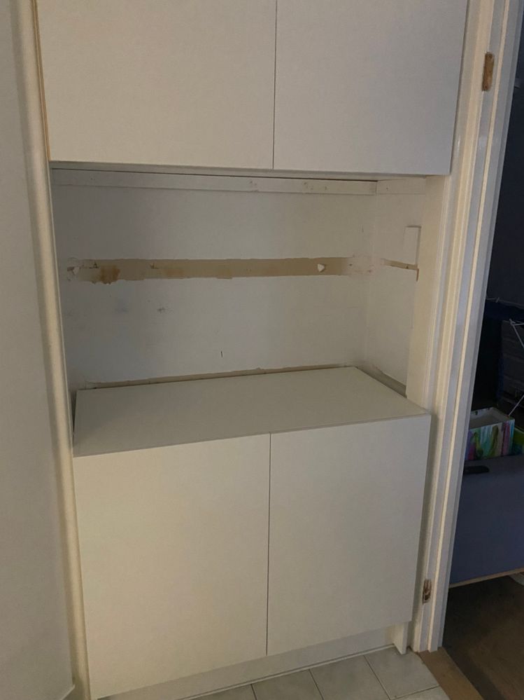

1st pic is the butlers pantry (which was originally a linen cupboard). I've used the Bunnings Practa units for the top & bottom so far, but want to have a wooden benchtop.

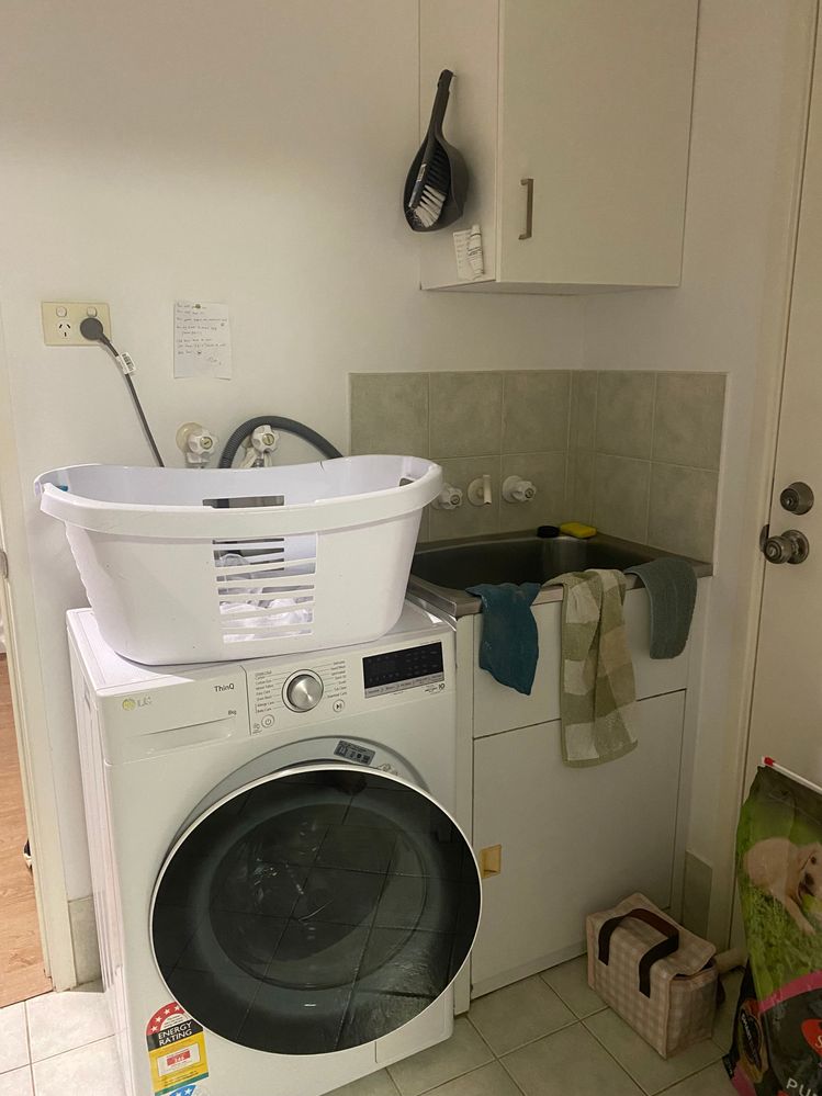

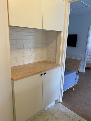

2nd pic is my current laundry space, and 3rd pic is what I'm trying to create for my laundry/wash basin area.

Hi @Bubbles50,
The panels you’ve listed could definitely work for your benchtop application, especially since you’re going with a top-mounted basin rather than a recessed sink. That reduces the risk of water damage with timber tops. Just be sure to seal the surface thoroughly with a suitable timber sealant or clear polyurethane to protect it from moisture, especially in the laundry area.
In terms of sizing, the Timber Multi-Use Pine Panel is only 405mm deep, which unfortunately isn’t wide enough to fully cover the Practa base cabinets, which are 500mm deep.
Either the Practa Acacia or Practa Rubberwood panels would be a better fit—they’re both 600mm wide, giving you enough depth to cover the units completely. You should trim them down slightly to match the cabinet depth.
You might like to have a read through this helpful step-by-step guide: How to renovate a European-style laundry.

Thanks so much Eric. The Cabot’s Benchtop timber finish worked a treat on the Rubberwood benchtop. The Mondella 600mm vanity, black tap and basin, and 7.5 x 30 gloss subway tiles look amazing.
