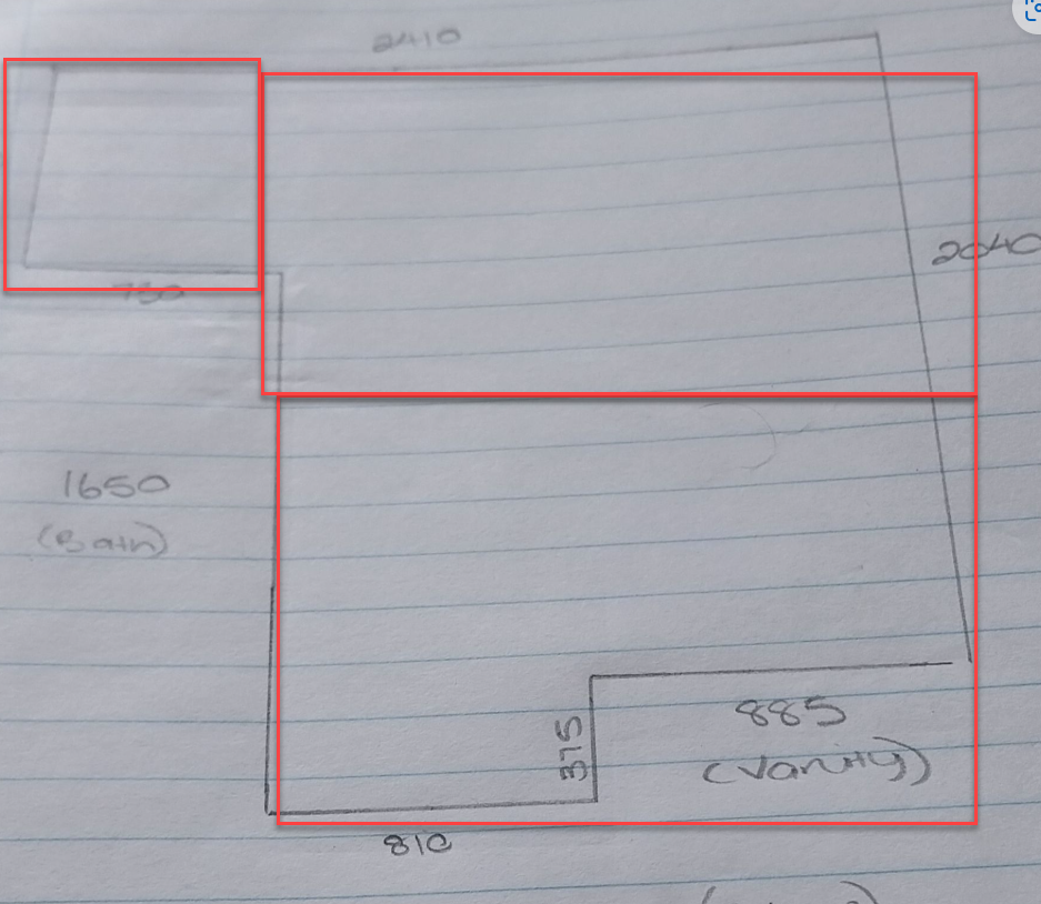

I am working out my shopping list to install new bathroom flooring. Currently it has yellow tongue subfloor (previously covered by looselay vinyl sheet). I want to install cement sheet underlay over the subfloor, then prime, then use self-adhesive vinyl planks.
What direction should the cement sheet and planks be layed? What transition strip do I install at the doorway? What type of floor waste/grate do I need as before the vinyl covered the pipe?

With this being said, you would typically run your Tile Underlay so that the joins do not line up with the Yellowtongue beneath. In your situation, you'd need 3 sheets and this is the layout I would use.
You would then lay your vinyl plank flooring perpendicular to this. As a general rule, floorboards should run perpendicular to the main doorway - that is, they should point in the direction you enter the room rather than lying side to side. This layout gives the best visual flow and makes the room appear longer and more cohesive when you walk in.
