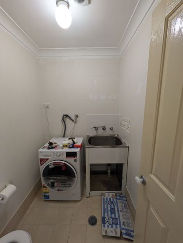

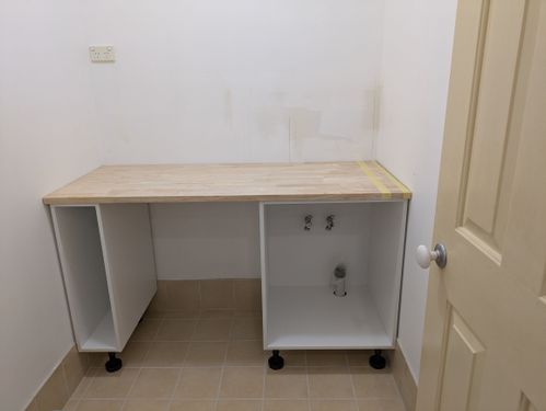

I'd like to ask about laundry plumbing. I'm renovating my laundry and I have asked a plumber to change the old wall mount laundry water inlet to an underside configuration and installing new cabinets/benchtop. My old laundry sink had the drain waste pipe from above. But now I have a benchtop, what's the best configuration of plumbing the washing machine waste drain to the sink drain? Does it have to be a specific height above the connection point to the sink drain pipe? And would an aerator be required for the pipe?
