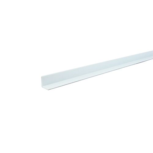

Hi Mitchell, I was contemplating an alternative solution and was thinking of using a 19mm x 19mm white PVC moulding to place around the base of the bath. Since the freestanding bath is essentially a rectangle, it would be easy to cut to length, and silicone it into place using Sika 11 FC. That way, the adjustable feet are directly in contact with the tiles as the base and the PVC moulding will greatly reduce any water entering from underneath especially with silicone in place. What are your thoughts?
Re: What self levelling compound suitable for putting on existing tiles?
That sounds like a good idea. It should work well for that application @newton.
