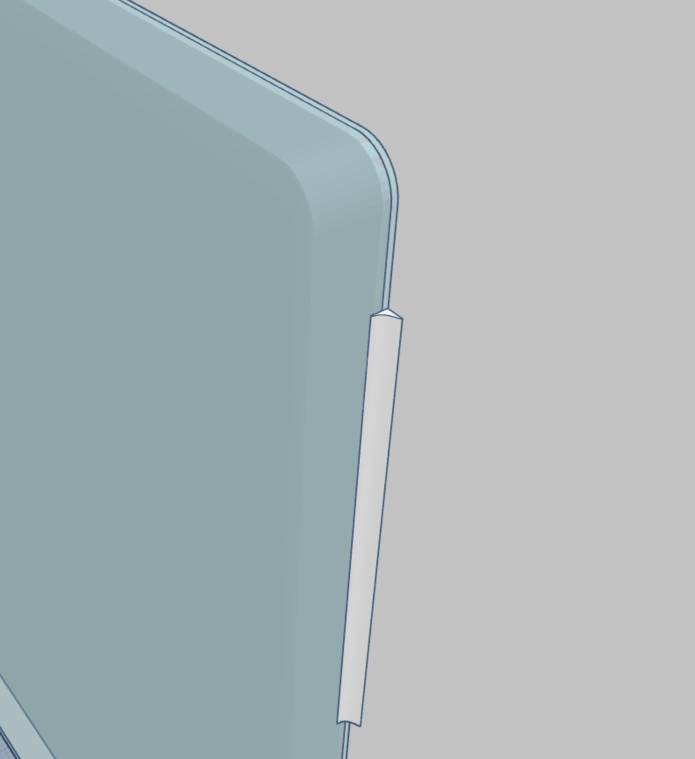

You just really need to seal the mirror to the backing/cabinet @alexreed092. The idea is that you want to stop moisture from getting to the side of the silvering and the rear of the mirror. No need to seal the entire edge of the mirror, since the silvering is a thin layer on the back. A small cove of silicone from the rear edge to the cabinet would be sufficient. One of these silicone cove tools would be helpful. Here's a useful guide: How to apply silicone sealant.
I've created the image below to illustrate.
