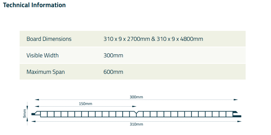

Since you’ve got a curved wall and want something that looks flatter and less stripy than narrow battens, you might like to consider an alternative product designed specifically for these situations. One option is the QuickBoard 300 x 9mm 2.7m Cedar PVC VJ Wall and Ceiling Lining Board (2 Pack). It has the look of cedar but is made from PVC, so it won’t swell, warp or rot in a damp ensuite. It’s also easy to work with, and once installed, it provides that warm timber-like appearance without the ongoing maintenance of natural wood. Depending on how tight the curve of your wall is, you may need to test the material first to see if it will bend and conform properly.

Thanks Mitchell, is this available in narrower strips, say 70mm, for a more shiplap effect?

Unfortunately, not @geoffr. It only comes in one profile. Though the 300mm board has a V-groove through the middle, which imitates two 150mm boards.
