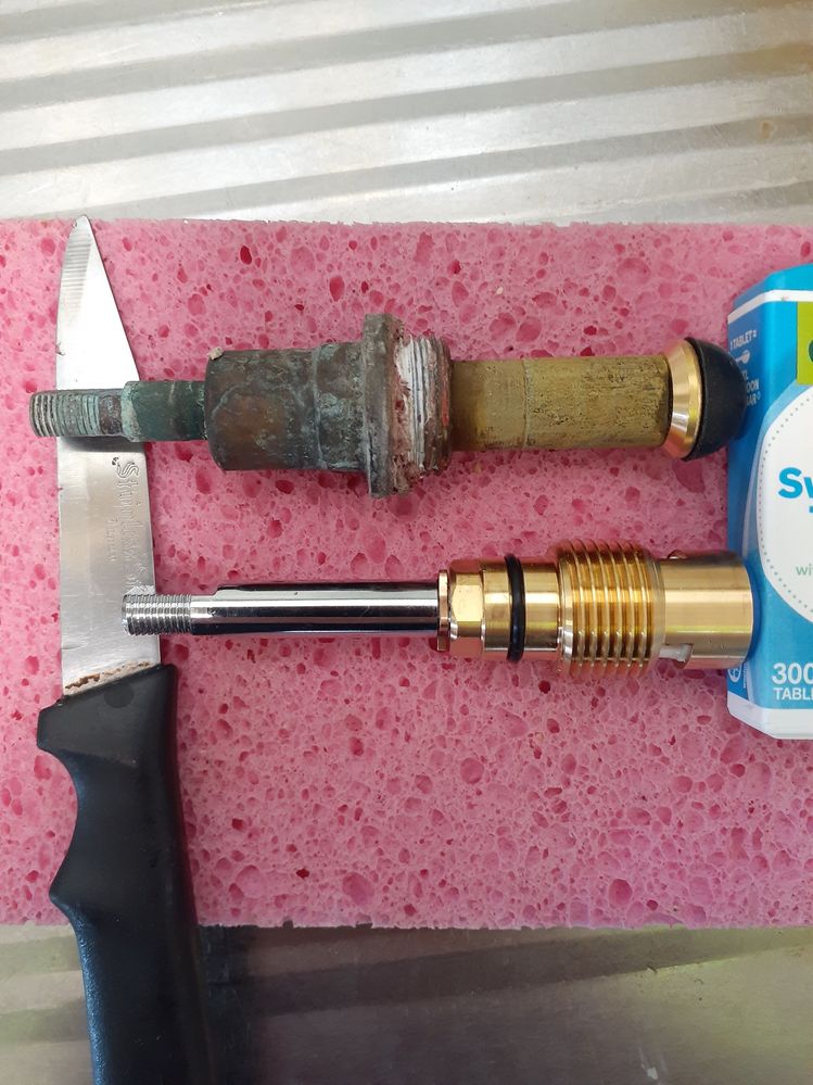

Not sure whether my Question has been answered or not. I bought some ceramic taps for an old house with old plumbing. It seems the distance between where the spindle screws in and the seat in the pipe is much longer then standard. The house was built in 1968 .The taps I bought were:
https://www.bunnings.com.au/shaw-mason-chrome-1-4-turn-lever-wall-top-assembly-pair_p0595282
Are there taps I can buy with the correct length (in pipe) spindle or are there extenders that extend in the pipe?
From this thread I see I should have measured everything, but old tap and spindle is back in place currently. Does a spindle extender work in my case and can it be estimated what one I need?
Thanks!

Hello @CeramicSpindle
Thank you for your patience and for sharing your picture of the spindles. Your old spindle which is called a deep-seated spindle is a classic configuration which was quite common back in the 70's. I'm sorry, but the store currently does not carry deep seated ceramic spindles. We do however have the Shaw & Mason Chrome Deep Seat Basin Spindle if you are after a standard upgrade.
If you look closely, you'll see that the threaded section of the ceramic spindle is quite low, and the body itself is short. This will tell you that they are not compatible with each other. In regards to your question about spindle extenders, these devices are only compatible with short body spindle bases. My only other suggestion is to get a plumber to upgrade the entire assembly to the short type of spindle bases.

Thanks very much to both of you for replying, The ceramic is needed for an elderly person who has trouble with turning the taps so I think we'll have to get the plumber in. Both been very helpful to the extent I don't need to ask anymore questions
Thankyou again! (Such a good idea this board)
