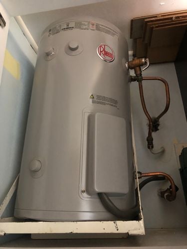

Hi folks.
hot water service is coming to end of life (10 years) and would like to switch from older style (see pic) to the smaller instantaneous electric system. Nb. No gas in block.
plumber mentioned something about older blocks and ‘phasing’ and it not being compatible but when I asked me questions he confessed to not really
knowing.
he has quoted $2500 (3k for longer lasting 15 yr stainless steel option) for replacement including install an valves and so forth.
am wondering how I work out if technically the smaller system is an option or I’m stuck with yr olde approach? 🤔
