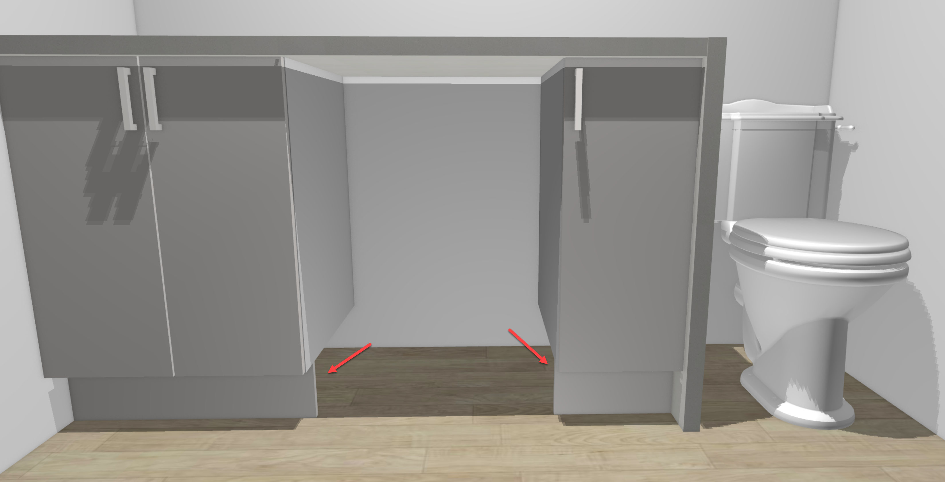

Hi @FleaK,
I just had a quick play around with the Kaboodle's 3D planner (if you are in NZ - 3D planner) to confirm what I said was correct.
Without the end panels, this is what it would look like.
With them, this is what it would look like.
This is obviously a much more finished look.
I just thought it might be worth seeing it, so you can confirm I am understanding you correctly, and so you can see a physical example.
