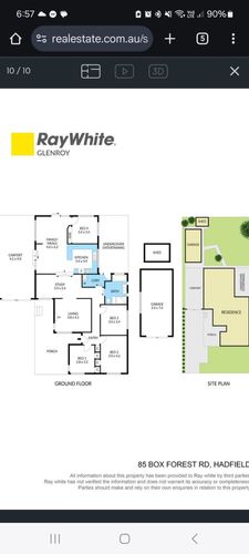

 want to know where a second toilet could be put?  Bedroom 2 or the laundry?

From an installation point of view, I propose locating the extra toilet in the laundry. Depending on your budget, there are several ways to reconfigure the area so that you can have an extra shower and bath. The wall separating the bath and laundry can be removed and turned into a straight wall. This will provide you the space you need to turn the bath into a shower and provides the space for the new toilet.
From a plumbing point of view, digging the channel from the current bathroom to the new location should be straight forward and should not present any complications. If you can please provide the wall dimensions of the current toilet along with the laundry, I'll be able to draw up a sample layout for you.

I would go with the laundry, it has services allready in and around and you wouldnt be sacrificing space within a bedroom.

The laundry is already very small. What about turning Bed 1 into a master and open up the wall in to Bed 3 and create a walk in robe and ensuite?
